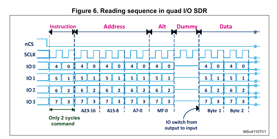

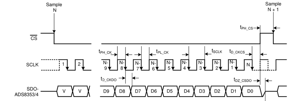

After brief review of AN4760, I get an impression that QuadSPI was specificaly designed to interface Flash memory IC.
ADC has absolutely different requirements in respect to timing on CS line, clock - 32 SCLK clocks with 16 data bits.
See pictures:

Why no QSPI ?
2024-12-01 3:19 AM
See pictures:
