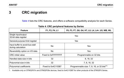

Greetings,
I have used CRC peripheral in STM32G0B1 and its working fine. I am using this peripheral to calculate 16-bit crc. How to accomplish same task in STM32F207ZG ? I am using HAL and after code generation crc init code is very incomplete as per me. I have compared CRC init code for STM32G0B1 and STM32F207.
Please guide on using CRC peripheral and code generation for STM32F207 using HAL.
1 REPLY 1
STOne-32
Dear @NimitVachhani ,
This is not possible to use 16-bit CRC on STM32F2 series , they implement our legacy first version with fixed 32-bit Polynomial. Have a look on this Application Note :
https://www.st.com/resource/en/application_note/an4187-using-the-crc-peripheral-on-stm32-microcontrollers-stmicroelectronics.pdf
