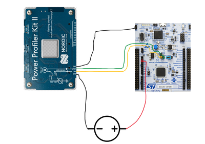

I have ordered NUCLEO-G491R to test STANDBY mode power consumption. The power consumption measurements are taken via the PPK2 from Nordic.
https://www.nordicsemi.com/Products/Development-hardware/Power-Profiler-Kit-2
The steps:

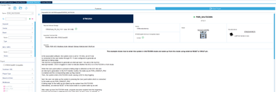

1. Take STM32CubeMX example project PWR_SHUTDOWN that is available for the Nucleo board.
2. Program the board (ensure the JP5 jumper is at the 5V_STLK position)
3. Remove the JP5 jumper because we will be powering the board via the external 3V3 (PPK2)
4. Connect the PPK2 to 3V3 and GND on the board.
5. Start sampling

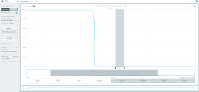

See the results below:
When the device enters STANDBY, the current consumption is measured at about 1.5mA which is way above what is declared on the datasheet.
What could be the reason that I cant achieve the declared current consumption for the STANDBY mode via the official example project? I am convinced that measurements of the PPK2 are valid as I have used this board in the past to measure very low currents and it was showing reasonable results.

mƎALLEm
January 19, 2026
According to picture you shared, you seems measuring the current consumption of the board not the power consumption of the MCU.
You need to measure the power consumption on JP6.

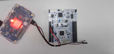

I continue my experimentation:
I have opened all solder bridges apart the two:
SB11 and SB38
At this point I feel like I have removed almost everything what's possible.
When powering the board via the external 3V3, the board current consumption is 600-700uA, the MCU itself current consumption is around 260uA
I am not sure what else I could try/measure to understanding what is happening and what causing the current to be higher than expected. I am considering removing (desoldering) the components one by one from the board that could have such affect but not sure if that makes any sense.

Hello @LPetr.1
Can you please try to run the attached project and measure the current consumption on your Nucleo board? Also, compare the results with your custom PCB to evaluate the current hardware against the Nucleo board.
I tested standby mode with the Nucleo G491 and measured several tenths of microamperes. I could not reach 1.4 mA.
The board already consumes 1 mA in run mode.
Also try to measure it using a calibrated ammeter
BR

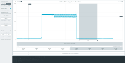

GyessineBest answer
February 2, 2026
Hello @LPetr.1
After further investigation, higher power consumption results from two main causes:
  • PB8-BOOT0 pin: Based on the product datasheet  it's not recommended to leave this pin unconnected, because it does not support analog input mode. If the pin is configured as BOOT0, set a defined logic level to ensure proper entry into the bootloader. If the pin is configured as PB8 by reprogramming the nSWBOOT0 option bit, it operates as a standard GPIO; however, analog input mode is not available. You likely removed jumper JP7 (BOOT0 jumper) on the Nucleo board, so pin PB8-BOOT0 is floating and causes power consumption depending on noise on this pin. Touching this pin changes the power consumption.
  • Debug registers: You probably tried to debug the project, which activated the debug registers and caused the 1.4 mA consumption. You must clear the debug registers manually after each debug session when you want to run the project again. Try to insert the appropriate code to clear the debug registers.
    You can use this code sequence :
  • DBGMCU->CR &= ~(DBGMCU_CR_DBG_SLEEP |
     DBGMCU_CR_DBG_STOP |
     DBGMCU_CR_DBG_STANDBY);
     // If your device has APB1/APB2 freeze bits and you want timers to run
     // while debugger is attached, clear those as well.
     DBGMCU->APB1FZR1 = 0x00000000U;
     DBGMCU->APB1FZR2 = 0x00000000U;
     DBGMCU->APB2FZ = 0x00000000U; /* USER CODE END Init */
Here is a screenshot where I managed to get nA consumption with these tips.
If your issue still persists, please do not hesitate to provide feedback.
If this information solves your issue, mark it as a solution so that other ST community users can reference it.
Gyessine
