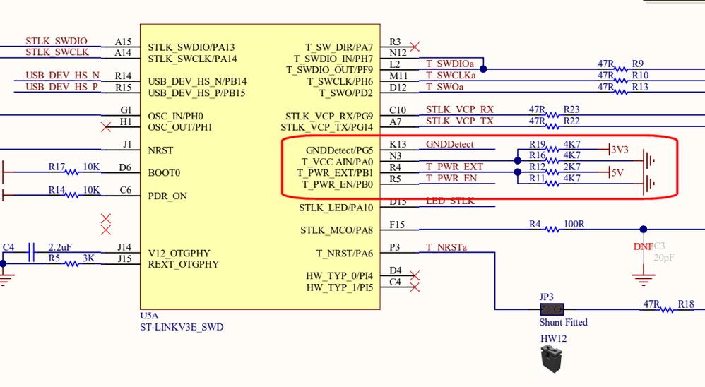

@LPetr.1 wrote:
regarding the
  • Target VDD measurement by the ST-Link.
It is not fully clear what you mean, perhaps you could clarify?
When you connect to, say, CubeProgrammer, you'll see that it reports the Target voltage.
To do this, the ST-Link needs a connection to the MCU supply in order to measure it.
In this case, it looks like you're OK:
The "3V3" there is isolated by removing JP6.

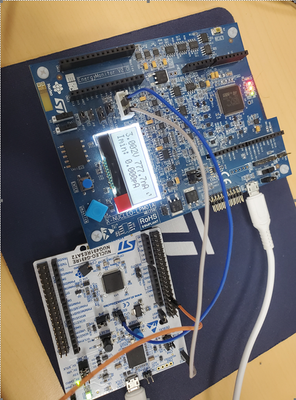

Hello @LPetr.1
After further investigation, higher power consumption results from two main causes:
  • PB8-BOOT0 pin: Based on the product datasheet  it's not recommended to leave this pin unconnected, because it does not support analog input mode. If the pin is configured as BOOT0, set a defined logic level to ensure proper entry into the bootloader. If the pin is configured as PB8 by reprogramming the nSWBOOT0 option bit, it operates as a standard GPIO; however, analog input mode is not available. You likely removed jumper JP7 (BOOT0 jumper) on the Nucleo board, so pin PB8-BOOT0 is floating and causes power consumption depending on noise on this pin. Touching this pin changes the power consumption.
  • Debug registers: You probably tried to debug the project, which activated the debug registers and caused the 1.4 mA consumption. You must clear the debug registers manually after each debug session when you want to run the project again. Try to insert the appropriate code to clear the debug registers.
    You can use this code sequence :
  • DBGMCU->CR &= ~(DBGMCU_CR_DBG_SLEEP    |
                          DBGMCU_CR_DBG_STOP     |
                          DBGMCU_CR_DBG_STANDBY);
          // If your device has APB1/APB2 freeze bits and you want timers to run
          // while debugger is attached, clear those as well.
          DBGMCU->APB1FZR1 = 0x00000000U;
          DBGMCU->APB1FZR2 = 0x00000000U;
          DBGMCU->APB2FZ   = 0x00000000U;  /* USER CODE END Init */
Here is a screenshot where I managed to get nA consumption with these tips.
