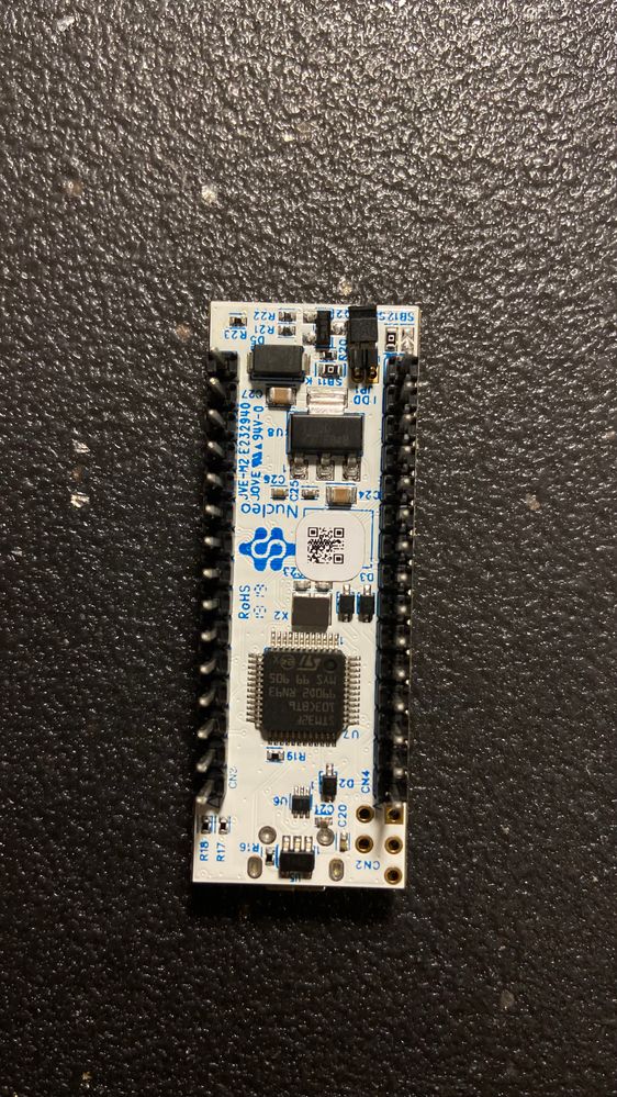

Hi there,
I have a Nucleo-G031K8 evaluation board and am unable to get the program to start when connected to an external power supply. I have a bench top power supply connected to the VIN pin with 12v+ The LD2 led is light indicating power is working but the program fails to initialize and LD1 slowly flashes. The program works as expected when connected to my pc via USB but the program won’t start when using the external supply. The board is in it’s default configuration with respect to jumpers and solder bridges and I opened a brand new unit and attempted to power it via the VIN pin before connecting it to my PCB to verify that no circuit issues or damage is causing this. Please advise.
Thanks

LD2 indicates the device is getting power. Technically, that's the 5V rails and not VDD, but unlikely there are power issues. Likely it's running code somewhere.
LD1 flashing means the USB has not connected to the PC. Do you have a USB cable present?
You can attach a debugger without resetting to see what it's doing. Would be informative to explain what "program won't start" and "works as expected" mean precisely.
Note that 12V is max allowed and that current usage is limited. I'm assuming "12v+" means "+12V" and not "more than 12V".

Double check what solder bridges are made/open as necessary so the board isn't held in reset.
Is the L1 LED blinking just a secondary effect of what the ST-LINK F103 IC is doing, and not related to what the G031 should be doing?
Have your G031 code do something simple you can validate. Have it self clock, via HSI or MSI, or whatever it starts on.
> my power supply is 12v but after the voltage drop through the regulator I get 10v on the VIN pin on the board.
So you're suppling an external voltage regular with 12V, then using the 10V output to supply the VIN pin? Should be fine, if convoluted. How much current is it using and is the 3.3V line stable?
> I can get it to start working by supplying 3.3v to the RST pin
That's weird. So after supplying VIN power, NRST is low? Forcing this pin high isn't a good idea as it prevents internal resets. If it's low, figure out why and solve that.
Did you attach a debugger to see what it's doing? Although is NRST is low, that's why it's not running.
Are you sure the NRST solder bridge isn't made.

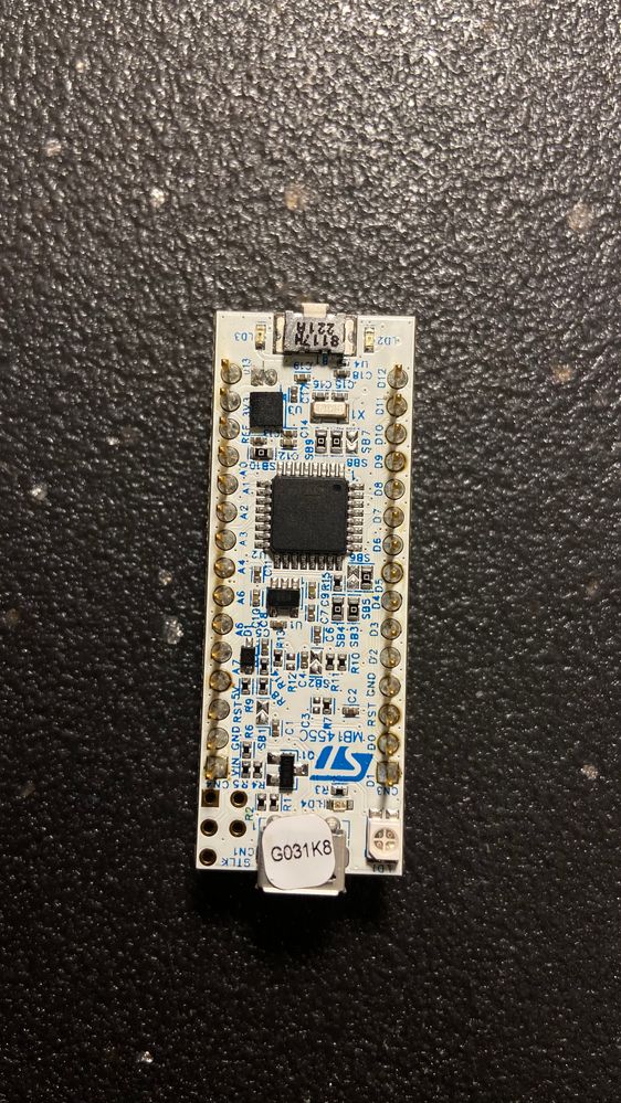

Take a clear photo of front/rear of board as you have it now.
High Resolution, In Focus

the solder bridges are in the default configuration as per the documentation on the NucleoG031K8 however I can’t see anything In the docs that suggest this default state would cause this problem. The docs also state that LD1 flashing like that is indicative of ST-LINK IC attempting its first USB enumeration with the pc, which is obviously not connected while using standalone power. I’m not sure how to bypass this.
0693W00000DlwOCQAZ.jpg0693W00000DlwNiQAJ.jpgimages of board.
My apologies I’m relatively new to the STM32 ecosystem here. Do you mean connect pc via USB to use the onboard ST-LINK debugger or connect my dedicated ST-Link dongle? Im not sure how to do that with the SWD pins not exposed on this board. Forgive me if I’m confused here. Seems like the STM32 mcu has a pretty steep learning curve.
