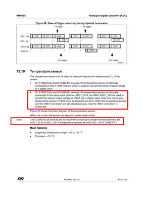

 The output came was show below, I have doubts in the internal temperature sensor value (INT_Temp)
ldr: 963 pot: 1200 INT_Temp: -103.000000
ldr: 960 pot: 1032 INT_Temp: -103.000000

waclawek.jan
Have you enabled the temperature sensor as outlined in RM?
I can't judge from source, I don't use Cube. Looking at the ADC registers content reveals the truth.
