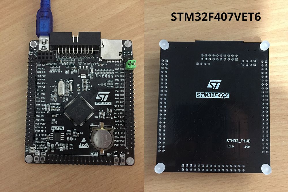

I'm having an issue with the error: failed to erase memory on STM32F407.
I'm using the board https://github.com/mcauser/BLACK_F407VE
and the debugger https://github.com/WeActStudio/WeActStudio.MiniDebugger.
and the original STM32F407VET6 chip.
Yesterday there was no issue, but today when I tried to continue my project, the problem appeared. I have set the SWD frequency from Auto to 100 kHz. At some point, it worked with BT0 = 0 and BT1 = 0 after several attempts of pressing the reset button before starting the debug. I have replaced the debugger twice and tried it on the same chip type on a different board, and it worked. However, it did not work on the chip on my project board. I tried it with the STM32Programmer, and the same problem occurred—it could not erase during download. Strangely, full chip erasure could be done, and the connection was normal with no issues.

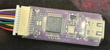

1- What you suspect you did yesterday on the board to make that happens? What kind of programs you uploaded to the MCU? Flash write/erase?
2- If you are able to do a full ship erase, are you  seeing 0xFFFFFF content in the Flash with the STM32CubeProgrammer at the sector 0? could you do a MCU program after?
3- What kind of hardware tool you are using to connect to the board? STLINK? Could you please take a picture of your probe and share it with us?

1). I don't feel like I'm doing that; I program it as usual on the main application.
2). If after a full erase at start offset 0x00000000, everything is FF.
Sometimes there is an error warning like “protection”; I don't read it anymore. I repeat it again and the full erase is successful, but the download still fails when erasing the download.
3) Yes, STLink is probably modified with the original ST chip.
If the problem is with the cable, I don't think it's a problem because when I tried it with the same debugger and cable with the same chip but on a different board, it worked.
When I bought the project board, the chip was a Chinese clone, so I replaced it with the original one so that it could be used on STM32CubeIDE.
I have tried replacing the chip with a new one, but the same problem persists. My conclusion is that there is a problem with the board, but I don't know exactly where the problem lies.

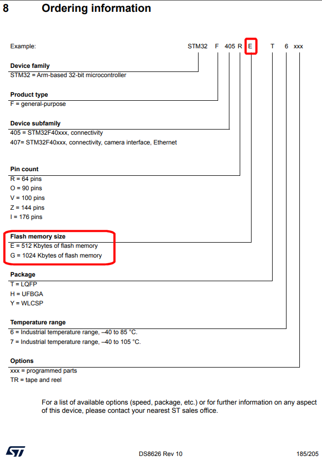

Have you tried using a genuine ST Board, and genuine ST ST-Link?
Does ST release a project board for STM32F407VET6?
The way to find out would be to go to the STM32F407VET6 Product Page, and look on the 'Tools & Software' tab:
https://www.st.com/en/microcontrollers-microprocessors/stm32f407ve.html#tools-software
It suggests the STM32F4DISCOVERY Discovery kit with STM32F407VGT6 MCU.
The only difference between VET6 and VGT6 is the Flash size:
https://www.st.com/resource/en/datasheet/stm32f407ve.pdf#page=185
via: https://www.st.com/en/microcontrollers-microprocessors/stm32f407ve.html#documentation
