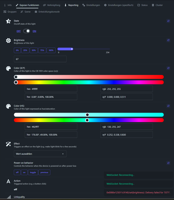

I am currently trying to develop a dimmable color light with an stm32wb55 (Nucleo Board).
Everything seems to work when connecting the device to a zigbee2mqtt server over zigbee.
But actually all color server related callbacks are never invoked and i have no clue why.
The other clusters are working just fine and the callbacks are called (on/off, brightness).
My endpoint setup code:

The device shown in zigbee2mqtt:
I attached the full app_zigbee.c file aswell.
Maybe one has an idea whats going on here, as all other function callbacks are working as expected. Its just the color stuff :)
