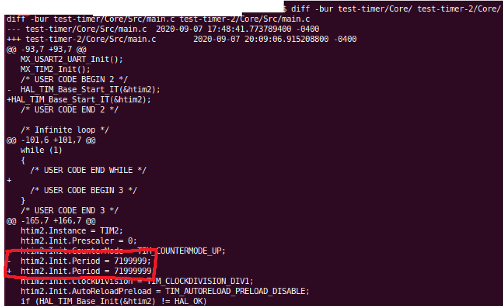

I wanted to have a failsafe timeout using TIM2 on a 1second timer.
Basically every 1s a timer interrupt is called, and the program checks for a flag. If the flag is down, then I know that it's been 1s without proper data coming in and that the PWM output should be disabled.
For some reason I can't get that simple TIM2 to work.
So I decided to pull the Nucleo board again and create a super simple project that does nothing but toggle a LED on a 1s TIM2 timer.
  • on the first try I had messed up the RCC because I selected the wrong oscillator. Fixing the oscillator does NOT fix the problem. The LED toggle is still wrong. It toggles at roughly 5Hz, regardless of the TIM2 settings. Changing the period has not impact whatsoever. Still is a slightly different behavior that I am experiencing on the custom board. So, then:
  • I created a new project, same everything, but this time I carefully selected the correct oscillator on the first try, set up TIM2, generated code, compiled. And everything works perfect. 1 s toggles. I can change the period and everything works as expected.
So I am leaving the custom board issue aside for now, and I would really try to find out what's going on.
the 2 projects are identical, and couldn't be more simple. Your typical Timer Interrupt tutorial you find online.
However, one works and one does not. I wonder if CubeIDE somehow generated code when I had the wrong RCC config and fails to update that on subsequent code generations? I really don't know and that's why I'm here.
I uploaded both of these 2 basic projects here: https://gofile.io/d/1LTvVN
test-timer is the one that is blinking at the wrong frequency
test-timer-2 is the working test, which toggles the LED correctly
both of them are very similar. I went as far as reading the main.c line by line and couldn't find anything obvious. I also generated the pdf report but they didn't help.
I would appreciate if anyone could help steer me in the right direction.
thank you

September 8, 2020
Well, ultimately, what’s in the code is what actually matters, but it’s probably the same as in the IOC file.
I didn’t trust the download link. If you upload the zip files directly I would take a look.
September 8, 2020
Your timer period differs by a factor of 10 between the projects.

September 8, 2020
Okay. You said the projects were identical. They weren't, and the difference would absolutely describe what you're seeing.
It does not make sense that the value in "htim2.Init.Period" has no effect on the program. The only way that could be true is if you're not compiling/running the code that you think you are.
Smoun.1
Smoun.1Author
September 8, 2020
I just tried changing the value (Period) in code rather than cubeMX and it went through.
the value you see at 7,199,999 was not getting regenerated when changing the value in CubeMX.
well that fixed it! thank you.
