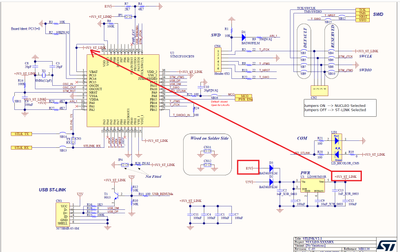

I have implemented the changes you suggested and the Nucleo board powers up and seems to run ok as long as I'm plugged into a PC...once I try to power the board off a 5V external supply nothing works.  I believe i've followed the instructions on powering the board externally correctly...
1) move JP5 to pins 2 and 3
2) Remove JP1
3) Attach external 5V to E5V pin on CN7 (pin 6)
The LEDs on the Nucleo board come on but nothing seems to work beyond that.  I suspect the external 8MHz being generated by the STLink portion isn't coming up...does this HAVE to be plugged into a PC to work?
That's strange.
According to the schematics, ST-LINK still powered even you are using an external power supply:
So yes if ST-Link is no more powered, no 8MHz outputted for your MCU.
Check the power supply on JP6.

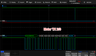

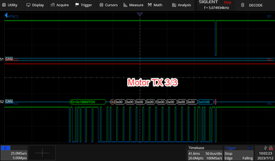

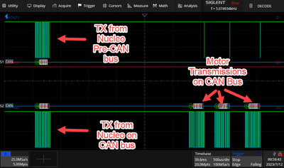

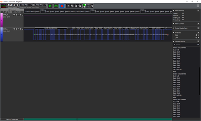

For now I will just power this with my PC to get it working again.  Once I do this, I am getting this steady state communication out of my Nucleo board and through the CAN transceiver once the motor stops trying to talk on the bus...however it's only transmitting on the CAN_L wire...nothing seems to happen on the CAN_H:
This is what it looks like when the motor initially starts up and seems to take over the CAN Bus and I see no traffic from the Nucleo board at all:
1) I don't really understand why the motor is talking on CAN_H and the Nucleo board talks on the CAN_L.  I thought these two wires were supposed to be directly opposite of each other all the time.
2) Why would the motor be hogging the line initially and then after 10-20 seconds it stops talking at all and then the Nucleo board seems to be allowed to talk?

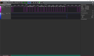

I was just able to confirm what wire should be CAN_H and which one should be CAN_L.  I did in-fact have them backwards.  When I connected them correctly all data transmissions only appear on the CAN_L, both data sent from the Nucleo board to the Motor as well as from the motor to the Nucleo board.  Here are some screen shots (data 1 = CAN_TX, data 0 = CAN_H, data 2 = CAN_L):
I did check to see if I disconnect the motor from the CAN Bus and only have the Nucleo board on it, the CAN_H signal still remains high the whole time.  I figured this would rule out the issue being with the motor controller...

I would also check the logic analyser settings and connections, and I would instead connect an oscilloscope, just to be sure...

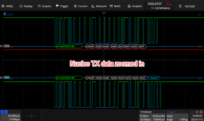

My apologies...I used the oscilloscope probes instead of the logic probes and now I see both CAN_H and CAN_L signals as I would expect.  I am still new to CAN and I wasn't aware that the "zero" for CAN is actually 2.5V...with that in mind here is the CAN_H and CAN_L with the decoded message coming from the Nucleo board:
As for why the motor is not responding I believe I may have to take that up with the motor manufacturer.  Thank you for your assistance!
