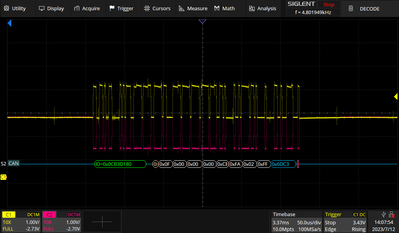

I am using the Nucleo-F091RC board to communicate with a Motor that allows me to change it's speed with CAN.  I have the nucleo board attached to an Adafruit CAN Pal board which has a TJA1051T/3 from NXP as the CAN transceiver but I have yet to actually connect the motor to the CAN_H and CAN_L outputs from the transceiver.  I am powering the board with 3.3V generated by the nucleo board and the CAN signals attached to PA12 and PA11 and Silent pin connected to PB12 generating a low signal all the time to make sure the transceiver is in "normal" mode.  I have been able to get the nucleo board to output a CAN message every 65ms and I can see it on the CAN_TX pin being output from the nucleo board to the adafruit CAN Pal.  When I attach my scope to the output of the transceiver (CAN_H) the signal is always High...no data.

My apologies...I used the oscilloscope probes instead of the logic probes and now I see both CAN_H and CAN_L signals as I would expect.  I am still new to CAN and I wasn't aware that the "zero" for CAN is actually 2.5V...with that in mind here is the CAN_H and CAN_L with the decoded message coming from the Nucleo board:
As for why the motor is not responding I believe I may have to take that up with the motor manufacturer.  Thank you for your assistance!

Thank you, that answers one question and explains why when the motor is connected I get traffic on the CAN bus.  That said, for the first 5 seconds after power up I get TX data out of the MCU and nothing on the CAN bus and then after about 5 seconds the MCU hangs and stops working all together and then the CAN Bus comes alive with a ton of traffic (presumably from the motor and not the MCU).
As I mentioned in my last post, I have not implemented any CAN receive code since I am not trying to talk back and forth with the motor...just give it commands.  Do I need to implement some sort of receive routines in order to not crash my code when there is data on the bus coming back at me?
I've attached screen captures of the CAN_TX line from the MCU as well as the CAN_H signal on the CAN Bus to show you what I'm seeing.

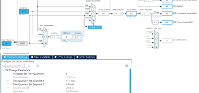

You have an issue with your system clock config:
--> RCC_OscInitStruct.OscillatorType = RCC_OSCILLATORTYPE_HSI|RCC_OSCILLATORTYPE_HSI48; ??? HSI or HSI48?
Also for CAN communication it's NOT RECOMMENDED to use any of the internal source of Clock HSI, HSI48 etc.. This introduce some instability in the communication. So you need to use HSE and an external crystal by soldering X3 or in your case you can use MCO source generated by ST-Link module (which in turn is generated by X1 a 8MHz crystal), for this you need to solder SB16 and SB50 (please refer to the board schematic) and you need to configure HSE in bypass mode:
RCC_OscInitStruct.HSEState = RCC_HSE_BYPASS;
mƎALLEm
I suggest this config for the system clock and CAN at 500kb/s
Please check the availability of the 8Mhz on SB50 with an oscilloscope.
