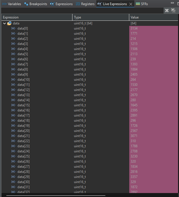

This is what the live expression tab looks like when functioning as expected. The data updates in real time.

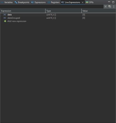

This is what the live expression tab looks like in subsequent debug sessions when not functioning properly

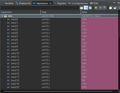

The expression can still be viewed in the Expressions tab but only when execution is halted
