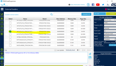

Thanks @KDJEM.1 and @Tesla DeLorean for your suggestions. I used the BSP files to communicate easily with the NOR Flash. The part mounted is a MT25TL01G. I was able to make my loader application working. Example QSPI_MemoryMappedDual is also a good reference.
But I did not know that there are already many loaders available for several STM32 boards in CubeIDe as well as Cube programmer. So for those who are new to this and for those who want to save some time, please search for your board in list. My board was STM32h747i-Eval board with MT25T01G which is already listed in both CubeIDE and Cube programmer. But it was a good learning, "QSPI_flashloader_CSP" is my custom loader application.
