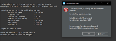

I am designing a custom PCB with an STM32H723. To programm it, i bought a brandnew ST-Link v3 MINIE. CubeIDE reads the serial number of the V3 but can not connect to the target.
- Target is supplied with VCC.
- From the Board-to-Board-Connector after a lengthy search i connected TMS to SWDIO, TDI to SWO. RESET, CLK, GND and VCC where obvious.
- BOOT0 i connected to GND.

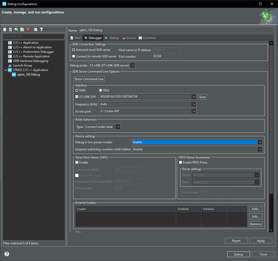

- Config as follows:
starting debuging i get this return:

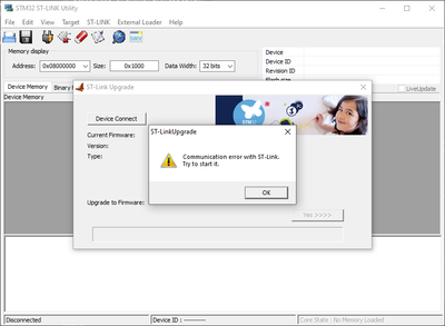

[EDIT: solved sidequest] Searching for solutions i found the programm ST-Link Utility and wanted to start by updating the firmware but the V3 gives me a communication error.

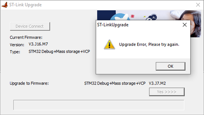

When i klick ok, sometimes a version is read and the "Yes" button for upgrade is enabled. But when i klick it i get another error:
I tried a different V3MINIE even a new USB-cable for this.
[EDIT: Solution for the sidequest] Use the upgrade only software named ST-LinkUpgrade.exe : https://www.st.com/en/development-tools/stsw-link007.html

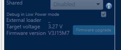

How is your board powered? The programmer does not provide power. Ensure the voltage in STM32CubeProgrammer is reflected correctly after you hit connect.
mstreicher
Thanks for the Tip.

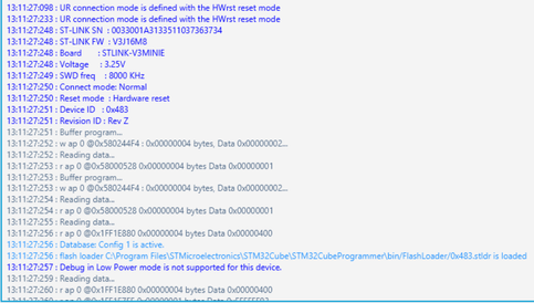

After I used the right File to install CubeProgrammer *facepalm* it gave me a valid Voltage and Firmware Version:

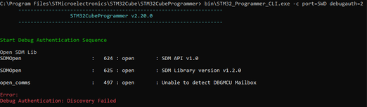

but the log tells me, i should use Debug Authentication
after a little search i found this Command Line:
Is there annything else i can do?
I am starting to think the MCUs of all my three prototypes could be fried.

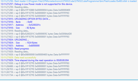

I took one MCU off the PCB, cleaned everything and soldered it back in place. CubeProgrammer actually connected and could read!
Then i tried debug mode in the IDE. It workt at first and then lost connection before it was ready for the play button. (unfortunatly lost te log of this part) I tried to reconnect in CubeIDE or CubeProgrammer with no success.
I am absolutely riddeled! Is there any false setting which could cause this kind of error?
