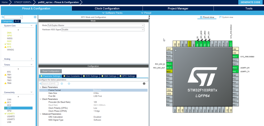

Now I switched to stm32 board I am using.
I have setup below and this is pretty much like what arduino code is using.

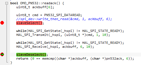

 @brief Tries to read the SPI or I2C ACK signal
bool OMO_PN532::readack() {
 uint8_t ackbuff[6];
 uint8_t cmd = PN532_SPI_DATAREAD;
 slaveSelect();
 while(HAL_SPI_GetState(_hspi) != HAL_SPI_STATE_READY);
 HAL_SPI_Transmit(_hspi, (uint8_t *)cmd, 1, 10);
 HAL_SPI_Receive(_hspi, ackbuff, 6, 10);
 slaveDeselect();
 return (0 == memcmp((char *)ackbuff, (char *)pn532ack, 6));

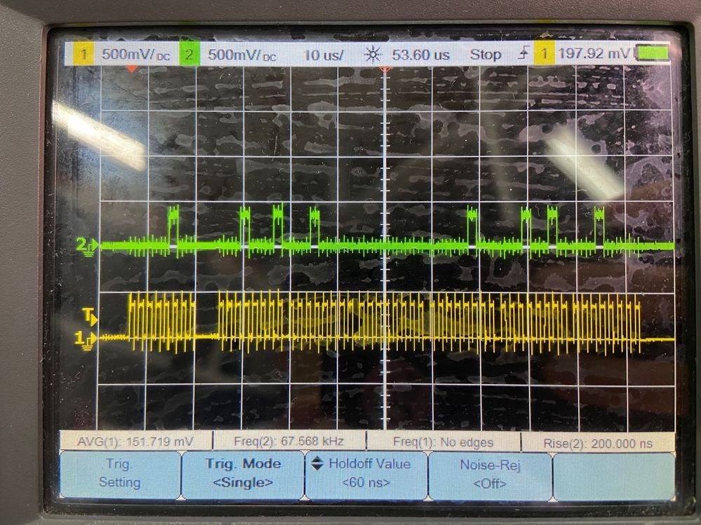

In this part, I am sending just 0x03 in the beginning then try to receive 6 bytes from PN532 however the scope shows entirely different thing

Below scope captured from MOSI (Green) and SCK (Yello) pins during below code debug.
0693W000005AvEyQAK.pngWhy there is no 0x03 in the first part of transmission and MOSI is keep sending something while receiving?

June 4, 2023
Your speed is <10MHz within spec. Have you checked the PHASE / POL config bits for this slave device ? 4 possible combinations.... the MIFARE has multiple interface, make sure when plugging on the STM32 the SPI is HW selected. As there is an internal 8051 code in MIFARE, add a SW delay in main() to wait for it to be up and ready to SPI dialog.
