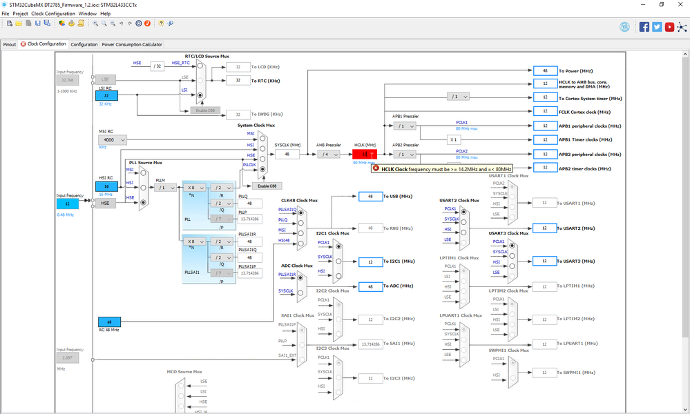

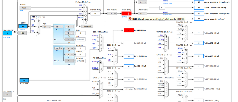

CubeMX doesn't like a frequency of 12 MHz for HCLK with the STM32L433CC.
HCLK is suggested to be at least 14.2 MHz, but I couldn't find any such requirement in the reference manual or datasheet.

You have peripherals clocking at 48 MHz.
Select 4 MHz MSI for ADC and CLK48-USB

Sorry, I don't understand your answer. MSI can't be selected for ADC, USB isn't happy with anything else than 48 MHz and HCLK still requests more than 12 MHz.

But you could use SYSCLK, why is SYSCLK at 48 MHz if you want to run the part at 12 MHz?
There is likely something CubeMX doesn't like, or as usual it is broken in some way, the part can definitely run at 12 MHz, but it seems to be warning about a potential clock inversion issue.

Yes, you are right. It would be more sensible to drive SYSCLK directly from HSE.
I am not sure the part really can run at 12 MHz while using USB. The file 'stm32l4xx_hal_pcd.c' assumes a HCLK of at least 14.2 MHz:

On the other hand this code is not executed on the STM32L433CC, which doesn't have a register called GUSBCFG. I assume the 14.2 MHz constraint only applies to STM32L4 parts with USB OTG functionality.
‎2018-06-21 9:37 AM
Yes, you are right; it's valid only for the higher-end 'L4. This is probably a bug in CubeMX.
There is a constraint, though, although different (see RM0394):
Note: Due to USB data rate and packet memory interface requirements, the APB clock must have
a minimum frequency of 10 MHz to avoid data overrun/underrun problems.JW
