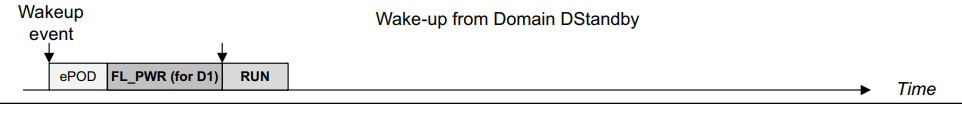

You can do that. After a system reset or System Standby, CPU2 will boot and CPU1 will remain on hold until CPU2 sets BOOT_C1 to ‘1’. You may refer to table 57 in the RM0399
Since D1 exists from DStandby, the power switch setting time and Flash memory power recovery should be set.
Hope this helps!

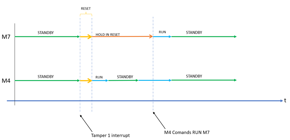

‎2023-03-02 3:45 AM
Hello again @F.Belaid​
I am working in this solution, but when we reset the system with tamper, the M7 restart too even if we don´t enable the flag BOOT_C1.
I made this behaviour timeline to help us. I need M7 to hold in reset when i use the tamper button, while M4 made the tamper callback, and then if I want re-boot the M7 app use HAL_RCCEx_EnalbeBootCore();
But when I made test, even not using this funtion the system reboot.
Thanks you
Regards!
