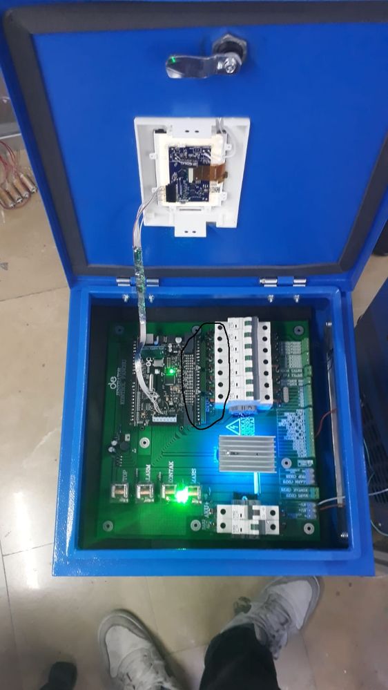

i have a an stm32f417vgt6 mcu and its connected with ft800 through 30 cm SPI cable
and the ft800 is driving a tft lcd .. the problem is when the mcu turn on or turn off the Contactor
the mcu halt .. can you please help me how to detect the problem and how to solve it and what couse the problem

‎2019-04-13 2:52 AM
yes its a relay that used to control high power, high voltage (110-250 vac)
i forget to mention that the Contactor is driven by an on board Panasonic relay
and its isolated from the board ,, the Contactor placed 40 cm from the board

‎2019-04-13 3:09 AM
@S.Ma​ when there is no 110-250 volt the MCU doesn't halt
@RomainR.​ the board is custom , the power source of the a MCU is a an 12 volt acid battery that goes to buck converter then through a LDO voltage regulator
the relay side have Transient Voltage Suppressor Diode ..

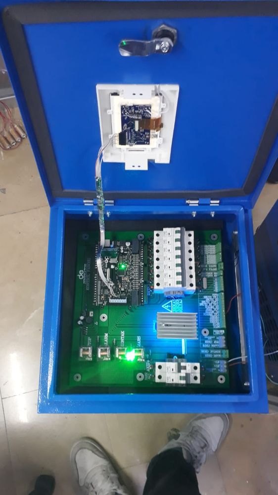

in the pic the black board is the controller board the blue one is the tft controller
the Contactor is in a different place
‎2019-04-13 3:21 AM
I suspect than High voltage line 110-250VAC is routed on PCB backplane ? Can you confirm ?
What is the type of load powered by High Voltage ?
You need to add a AC filter on high voltage.
And check your decoupling capacitor circuit before and after the LDO regulator.
‎2019-04-13 3:31 AM
Dear @RomainR.​ i would like to thank you for your fast responds
the load may defers it may be a home or a factory it may be resistive and it may be inductive
but or tests is done without any load connected
the high volatge is routed on the top-plane (cheak the pic )
the problem start happening after we decided to separate the tft from the black board

‎2019-04-13 4:33 AM
Maybe interference in the flat SPI cable generated by High Voltage.
Try also to replace flat SPI wire by shielded cable and route it away from all power source (on the left from picture)
