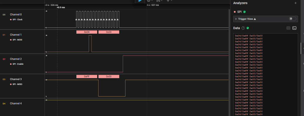

Trying to communicate MAX31856 With STM32F401
STM32CUBEIDE 1.15.1
ADAFRUIT MAX31856 Breakout Board
uint8_t data[2];
uint8_t addr_data[2]={0x04,0x00};
 while (1)
             HAL_GPIO_WritePin(GPIOA, GPIO_PIN_4, GPIO_PIN_RESET);
		 HAL_Delay(10);
	     HAL_SPI_TransmitReceive(&hspi1,&addr_data,&data,2, HAL_MAX_DELAY);
	     HAL_GPIO_WritePin(GPIOA, GPIO_PIN_4, GPIO_PIN_SET);
                HAL_Delay(10);
Trying to Read Register 0x04 (Default Value = 0xC0)
But Getting Random 0x00 or 0x80 Values (Verifying with Logic Analyzer)
Yes, but Right Now I tried to Chang the config to
 hspi1.Init.CLKPolarity = SPI_POLARITY_LOW; POL is Low
 hspi1.Init.CLKPhase = SPI_PHASE_2EDGE; Phase Changed to 2 Edges
And I am Able to get the Data Now.
Thanks @Andrew Neil

Correct SPI mode?
According to the datasheet the SPI Can be run in SPI 0 Mode (SCK POL 0 or 1)
and is your SPI configured to that?
Seems you have to set:
Thanks @Andrew Neil
