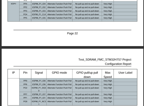

Please see my application and report from quick project with LTDC and SDRAM 16-bit (1 Meg Bits x 16 Bits x 4 Banks). I do not have any conflict.

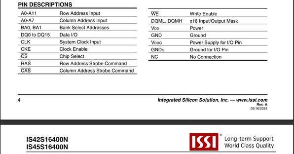

Additionally, I am sharing the pin details of my SDRAM for your reference:
SDRAM (IS42S16400N-7TL) – Pin Descriptions:
Test Report Pin Details
Here are the test report pin connections. Please explain how these can be mapped to the SDRAM interface:
Please confirm how these pins match the SDRAM connection requirements or provide guidance on how to connect them correctly. Also, kindly share a schematic diagram that matches this configuration.
The XSPI port is prepared for external Flash memory connected by OCTOSPI. I wanted only check possibility connect external Flash memory, SDRAM and LTDC in this version microcontroller.
