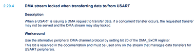

I am using STM32H753ZI nucleo board, developing with Keil IDE. I am using UART RX and TX DMA. I want to check if there is a possibility of corruption of UART data while transmitting with DMA Tx.
The sending device will send 8-byte defined command to STM32H753ZI and then STM after performing the required operation will send response in a 8-byte defined format.
My system works very well, but sometimes the UART data which is transmitted back to sending device in response to some specific command is seen to be corrupt or any random data other than defined protocol or packet message data
Also, it is seen that the data is sent to sending device without any command which the code never does (that data are mostly 0 0 0 0 0 0 0 0 all 0's of 8 byte).
I am doubting something has gone bad on USB to UART TTL module or USB hub or something in hardware. But just wanted to be sure if there is nothing missed from firmware side for DMA Tx with respect to corruption since DMA uses memory to store data.
Anything to be taken care with respect to memory assignment (stack and heap) in startup file for this?

How often are you receiving data? Are you possibly receiving data while transmitting?
Show relevant code
Almost certainly this is a code bug, not a hardware bug.
Is the DMA buffer valid during the transfer? It should be in global memory, not on the stack.
Edit: show your calls to sendUart1Data and surrounding context. That's likely where the bug is.

As per analysis, all the command's response was updated on global buffer. But for few commands, the response was sent through general sendStatus() and sendError() function (refer last functions in the earlier attached UART_DMA.txt file). Pointer to the global variable was passed to this function as an argument. Here, this function copies the data into its local variable and then further for transmission, pointer to this local variable is passed to task and its subsequent functions. Will check by making this variable as static.
But there is one more issue in addition to what all explained in this POST start description. The issue is in response to the command, STM sends response, but sometimes there is no response at all. Looks like Tx DMA got stucked. Only after STM restart, it recovers. I am doubting below errata sheet issue:
Can you explain how to recover from this issue using HAL functions.
