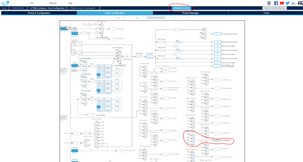

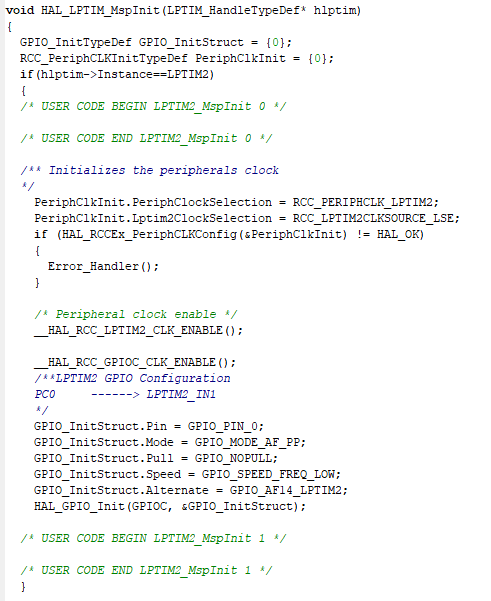

‎2022-10-18 2:51 AM
Hi @Community member​ ,
In the SystemClock_Config() , you have activated the MSI and LSE clocks and defined the MSI as the system clock source. Now you need to select the LSE as source of your LPTIM2 peripheral.
The easiest way to do that is by using STM32CubeMX to configure the peripheral and then generate the code. Please refer the images below
Best Regards,
A.MVE
