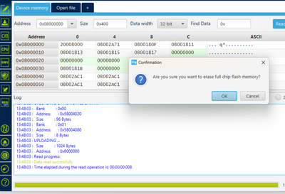

‎2023-12-22 4:50 AM
I usually only upload .hex code to the board using Cube Programmer.
Do you mean this erase as in the picture above?
‎2023-12-22 5:01 AM
Yes.
After that, upload your code to the MCU.
Best Regards.
STTwo-32

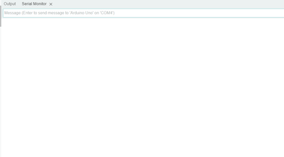

‎2023-12-22 5:18 AM
Nothing changed.

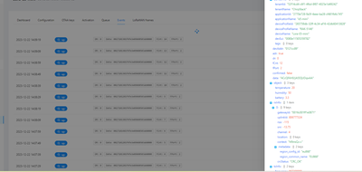

End device sends up messages to the concentrator as below:
But there are no debug messages on the serial monitor.
A few days ago, I saw debug messages from Lora WAN the end device.
