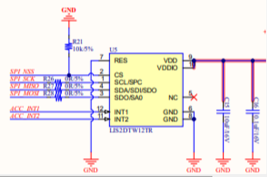

Please post your schematic showing the connections between the STM32 and the LIS2DTW12

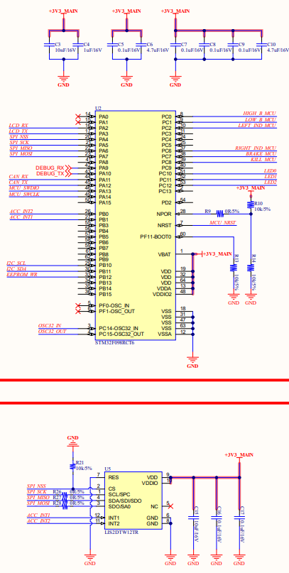

Here is the schematic:
The who_am_i register is not return the correct value(0x44). Instead it return 0xff.
2024-07-29 6:00 AM
@DivyaJayan wrote:The who_am_i register is not return the correct value(0x44). Instead it return 0xff.
That suggests that your SPI is not working at all. So, again:
- Are there any other devices on the same SPI bus? If so, are they working OK?
- Have you used a logic analyser or oscilloscope to verify what's happening on the wires?
The schematic image is too low-resolution to read clearly.

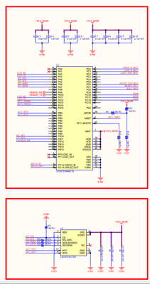

2024-07-29 6:06 AM
Here is the schematics :

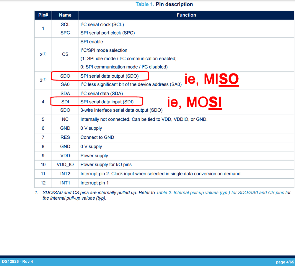

2024-07-29 6:14 AM - edited 2024-07-29 6:19 AM
Are you sure you have MISO and MOSI the right way around?
:thinking_face:

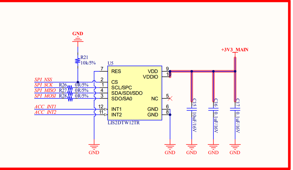

Your schematic is still pretty low-res:
2024-07-29 10:05 PM
Hi Andrew,
Sorry for the low picture resolution. Here is the new one, please check it.
