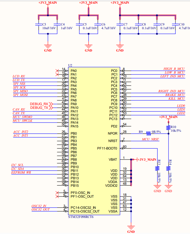

Please also post one for the STM32 part.
Why do you have a pull-down on CS ?
How is your PA4 pin configured ?
There is no other devices in the same SPI bus.

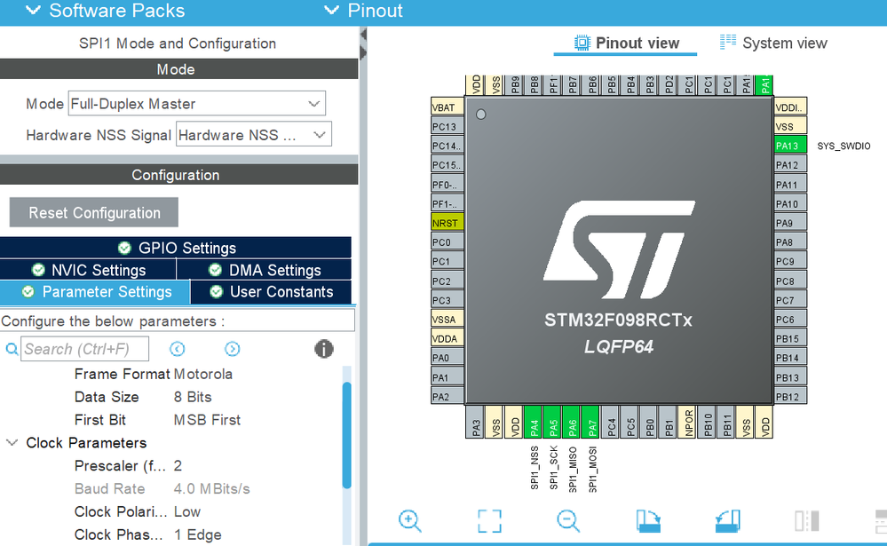

Here is the schematics of STM23 part:Screenshot 2024-07-30 144136.png
PA4 is configured as Hardware NSS output signal.
So that means it is controlled automatically by the SPI hardware - but your code is doing it in software.

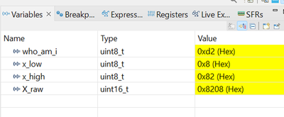

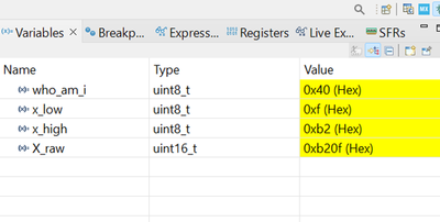

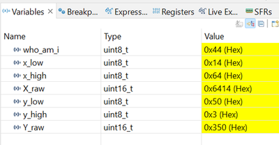

Hi Andrew,
I tried again and now I am getting different values for who_am_i register which include 0x44 also. But each time when debugging, different values are getting.
These are the values I got for who_am_i and x register.
Please go through it and comment on it. It will be so helpful.
Thanking you,
Divya
