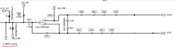

we are using the MCU in a 60V power supply where the output voltage is reduced to values between 0-2.7V using opamp voltage divider. The ADC is supposed to read the output voltage(after being reduced to 0-2.7V) and it's values are used to give the voltage reading for the user. the problem is that at some of our boards the ADC values are not accurate at some voltages. for example(at a problematic board) instead of reading 6V it reads 6.22 etc. we tried to manually replace the MCU at some controllers and the problem seemed to be fixed. BTW we are using ADC1.
July 17, 2024
0.22V out of a 60 V range is 0.3% error. Fairly low. Can you share your schematic? What are you doing to ensure the accuracy is what you want it to be? Op-amps will add additional error due to gain error, offset, and resistor uncertainties. You're going to see some amount of board to board variance.
