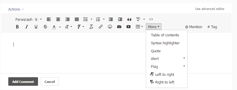

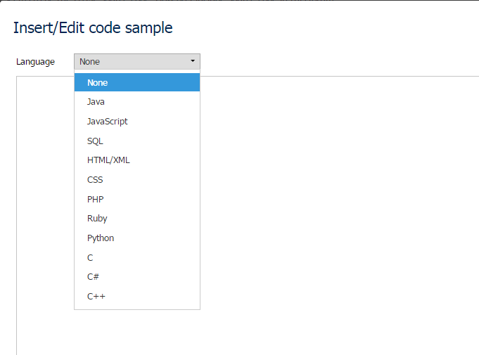

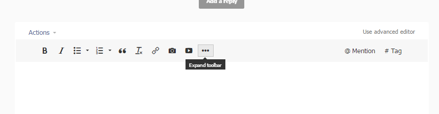

About
format source code, y
ou should expand toolbar by clicking on [
] icon :
Click on ''More >> Syntax Highlighter'' :
Then, insert your code in the appropriatelanguage:
