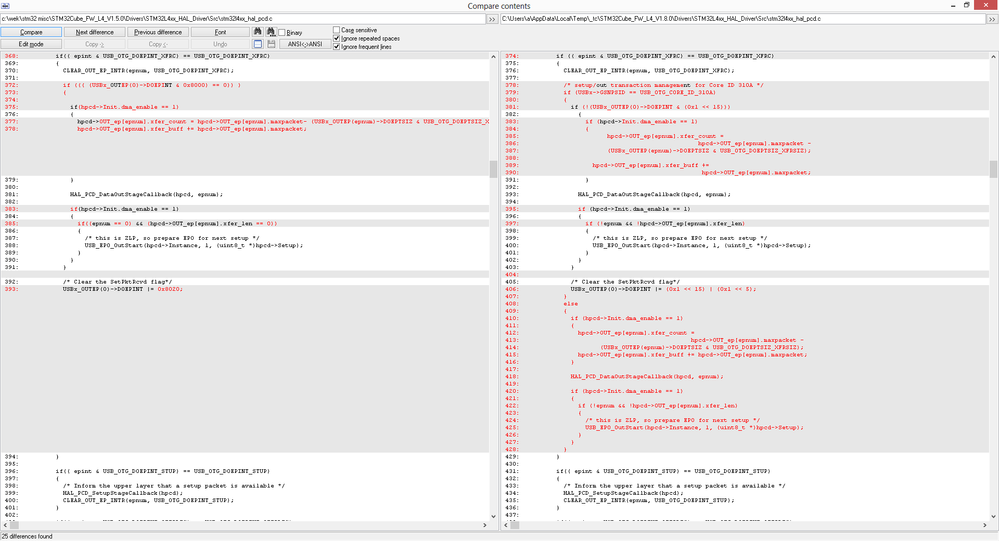

According to RM0351 Rev.4, all OTG_GINTSTS (interrupt status register) bits are rc_w1 (except those which are read-only or reserved). However, the macro supposed to be used for clearing these bits in [STM32Cube_FW_L4_V1.5.0]\Drivers\STM32L4xx_HAL_Driver\Inc\stm32l4xx_hal_pcd.h goes:
#define __HAL_PCD_CLEAR_FLAG(__HANDLE__, __INTERRUPT__)    (((__HANDLE__)->Instance->GINTSTS) &=  (__INTERRUPT__))
Not a hard bug, but IMO the RMW is redundant.
Am I overlooking something?

Meantime, things got worse. I am mostly interested in answer on question nr.4 the mysterious bits in DOEPINT.
Comparing old and new (v1.8) CubeL4:
And of course, not a iota of the Core ID register, or bits 5 and 15 in DOEPINT, in RM0351, as of now rev.5.
Can please this be resolved in less than a few years?

Posted on June 02, 2017 at 16:23
  • Fixed in RM0351 Rev5
  • Reported for other remaining reference manuals
Posted on June 02, 2017 at 16:43
Alreadu updated:
INEPNE is “râ€� (read only), B2BSETUP is “rc_w1â€�.
Posted on June 02, 2017 at 16:45
Bits 5 and 15 of DOEPINT shouldn't be reserved ==> to be confirmed and description of bits will be provided soon
