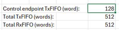

Nov 27, 2025 7:27 PM UTC
Here are the Beagle USB Analyzer traces (in the zip file) and the Excel spreadsheet containing the USB register contents.
The Interfaces sheet contains the interfaces and endpoint assignments, as well as the TxFIFO sizes for each IN endpoint.
The snapshots sheet contains all the register contents. The Timestamp field is the time at which the USB registers in a column were sampled, in nanoseconds, based on the ARM DWT timer. The Timestamp delta is the time between columns. The Post field indicates whether the USB register contents are at the start of the HAL_PCD_IRQ_Handler (post=0) or at the end of the HAL_PCD_IRQ_Handler (post=1). I have highlighted the columns representing the end of the IRQ in orange on the snapshots sheet. Red highlighting indicates that the field in the red column differs from the previous column so you can see at a glance when registers change value. Note that I did not read the DFIFO or GRXSTSP register contents to avoid interfering with the functionality of the USB stack.
The subsequent sheets are individual decoded register contents across the same time frame. I have put comments on the GRXSTSR sheet around column AZU and column BAO. I also added rows that provide the Beagle analyzer index (TotalPhase index), and sample time (TotalPhase time). I then take the Timestamp from the USB register snapshots and compute an Adjusted snapshot time that correlates the timestamp with the TotalPhase sample time.
If you zoom out on the GRXSTSR sheet you can see that the register contents stop changing at column BAR. It is at this point that the USB communications stop working properly (as can be seen in the Beagle analyzer as well). The INCOMPISOOUT event occurred in column BAO.

Dec 2, 2025 10:28 AM UTC
Hi @drmadill
Upon further review, your RxFIFO setup is indeed correct. I realize I may have overstepped in the initial investigation. The root cause of the issue is more likely related to the TxFIFO configuration.
Total TxFIFO size is 512 words, any adjustment to the control endpoint’s TxFIFO size must be carefully considered to avoid impacting overall FIFO allocation.
As I don't have your full SW setup, try to decrease TxFIFO . As I mentioned earlier, this article might be helpful. Some practical use cases are provided here for help.

Dec 5, 2025 10:50 AM UTC
Hi @drmadill
Sorry for the misunderstanding, your configuration for RxFIFO is definitely correct. However, try to dispatch the TxFIFO to the control EP0 and EP1 as follows:

Dec 8, 2025 3:27 PM UTC
Thank you for your reply. My current FIFO configuration is:
  • SetRxFifo=512
  • ep: 0x00 SetTxFifo=128
  • ep: 0x81 SetTxFifo=16
  • ep: 0x82 SetTxFifo=124
  • ep: 0x83 SetTxFifo=17
  • ep: 0x84 SetTxFifo=16
  • ep: 0x85 SetTxFifo=16
  • ep: 0x86 SetTxFifo=16
  • ep: 0x87 SetTxFifo=128
  • ep: 0x88 SetTxFifo=24
The TxFIFO sizes are based on the maximum packet size in the USB descriptor for that endpoint (except for the control endpoint, whose maximum packet size is 64 bytes). The total fifo size is 3988 bytes, which is less than the 4096 bytes of USB FIFO RAM available. The endpoint 0 size is larger than 0x10 because for some interfaces I am sending more than 64 bytes for the control packet (understanding that when the host requests more than 64 bytes from a control endpoint that those bytes will be split into multiple 64 byte packets. I thought that making the EP0 TxFifo larger would allow me to prestuff all the data to be sent to the host for the control endpoint into the TxFIFO).

Dec 11, 2025 5:47 PM UTC
Hi @drmadill
Even with packet multiplier 1 each this is not feasible. The minimum TxFIFO size for each IN endpoint is the maximum packet size in words for each EP. This depend on the type of each EP not number of bytes transferred.
To give better visibility on the answered topics, please click on "Best answer" on the reply which solved your issue or answered your question.Best regards,FBL
drmadillAuthor
Dec 13, 2025 10:00 AM UTC
The numbers I gave you for SetTxFIFO for each endpoint were in words, not bytes. I notice from your spreadsheet that you seem to have interpreted them as bytes. Also, I am currently using a packet multiplier of 1 for each IN endpoint.
Now, you claim that the maximum packet size in words for each endpoint depends on the type of the endpoint rather than the packet size specified in the USB descriptor for that endpoint (which is less than the maximum packet size allowed by a high-speed device in my case). However, what if I only write a packet to the TxFIFO if it is empty? i.e., the previous packet has already been sent (which is what I doing)? In that case, the TxFIFO will never have more than one packet in it. Would this not be handled properly by the USB core?
Dec 15, 2025 10:30 AM UTC
In my understanding, Yess @drmadill
You get my point. Remember, you send ZPL (zero packet length in USB communication standard) when the data length is an exact multiple of the MPS to explicitly signal the end of a USB transfer.
Still waiting for expert confirmation.
