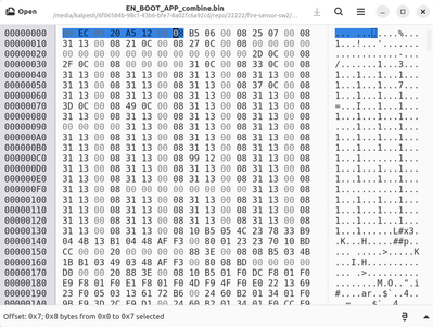

How system check the user code is there?
First 2 words from address 0x08000000, First word is MSP(which falls in RAM), and second is PC(which falls in ROM), Attaching image? It means Flash always contains valid code.

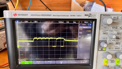

How do I verify that the system executes the embedded/system bootloader?
When there is no power, Power lines are at 0V.
As soon as the super capacitor has enough voltage(~2V), the Output voltage increases(From 0 to 1.8V) and reaches above 1.71V(Default brownout level), the controller starts, and PA4 & PA7 are floating by default, then the internal boot loader executes and switches it high and low, And external circuit sucks all the power and controller brnout immidietly. That kind of operation on PA4 and PA7 we never do in our code on power up, because we just sleep on the first line of the code, until the supercapacitor reaches 3.6V and gives an interrupt to wake up and do the job. Attaching an image for more clarity. Here, slightly bottom yellow pulses are on PA7, and the top green line is VDD to the controller.
