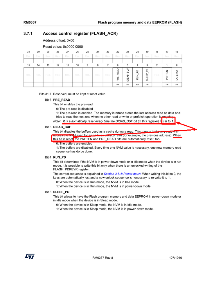

'L0xx RM FLASH_ACR contradictory description
waclawek.jan
0693W00000UoFaiQAF.pngJW

Hello @Community member​,
Thank you for bringing this issue to our attention.
I confirm the issue: The DISAB_BUF bit description is wrong in the RM.
I reported this issue internally.
Internal ticket number: 136992 (This is an internal tracking number and is not accessible or usable by customers).
