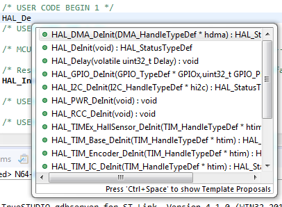

Posted on January 22, 2018 at 18:28
Keil vs
TrueStudio (diffs that slow me down)
Editor Intellisense
Keil is hands down, better and more responsive than
TrueStudio.
I have to hit ALT space in
TrueStudio
Look what TrueStudio gives me when i am 6/9 of the way to HAL_Delay! LOL
Viewers for Registers and Peripherals)
TrueStudio offers a single viewer, for all mpu regs and periph reg.
Every time you recompile and return to the debug perspective, the tree collapses!
It your watching a periph at the bottom of the list, you have to scroll down and re-expand... LOL
Keil you can open separate viewers of each peripheral!
Keil periph viewer does collapse on closing debug, but its only one click to see the bits a periph
 reg.
Keil mpu reg  viewer is separate viewer stays expanded.
I hope ST/TrueStudio will copy this, but ...  leave the view expanded!
That's the view that i setup! Don't change it til i change it!! LOL
