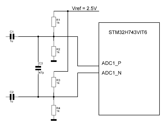

Hi! I use embendded ADC1 channel 3 in STM32H743VIT6 for sampling data. Input in differential mode. For improve SNR i added capacitor 47pF parallel to diff input pins see fig1. 0693W000001smNPQAY.gif

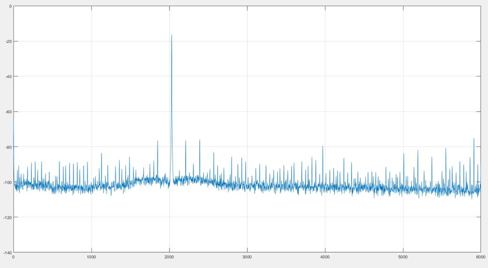

This led to decrease noise floor level, but its produces many spurs see fig below.

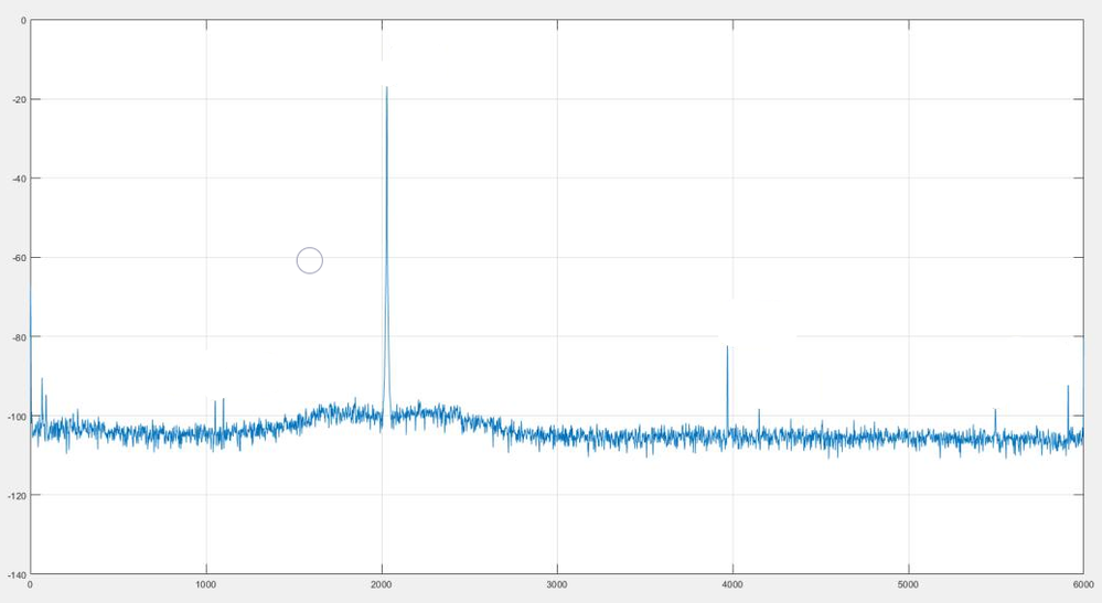

If i remove this capacitor (47pF) spectr became look very good see
Please help me to understand how this capacitor impact to input driver and produce nonlinear products?
