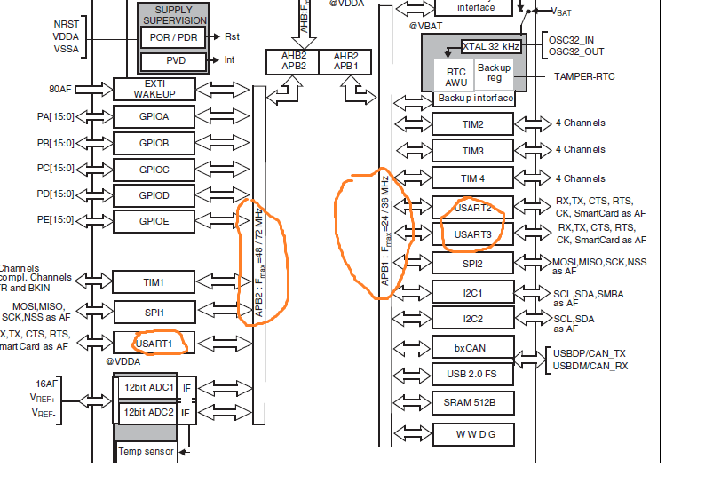

hi everyone, i would like to know if anyone has faced the same probleme : so i'm working with keil uvison5, i have build usart2 (PA2-->Tx / PA3-->Rx), everything works, and the message is printed correctly in the serial monitor,
but when i'm trying to use USART1 (PA9-->Tx /PA10--Rx), also USART3, the code is compiling but nothing is printed in serial monitor,

USART1 is on APB2. Your BRR value suggests your system clock is 36 MHz, but I bet it's 72 MHz and BRR should be doubled.
> i think that it could be related with the compiler keil itself ??
Based on what information?
‎2020-07-02 3:31 AM
Thank you for your response,
Following the block diagram the microcontroller, USART1 is on APB2 bus -->72MHz, USART2 and USART3 are on APB1 bus -->36Mhz.
the reason why i'm suspecting Keil : USART2 is working perfectly, but usart3 which is on the same bus, so logically use the same BRR, doesn't work, i have activate the clock for USART3 and the other small modifications, but the problem is still here, nothing is printed.
