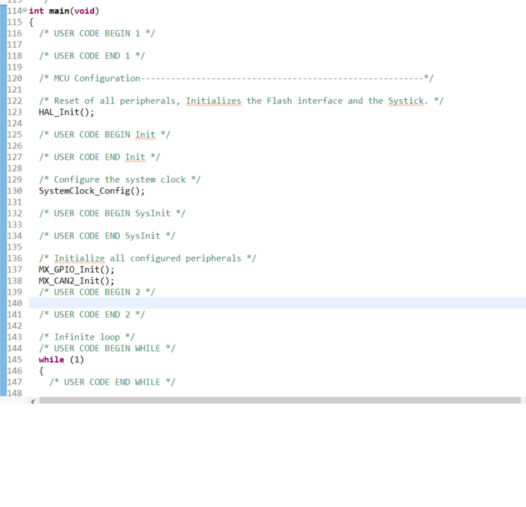

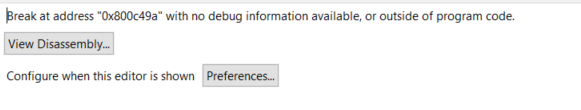

Here:
looks alright, is the systick ticking at all?
Take a look at "uwTick" variable in your live expressions while debugging
Available for consulting/freelancing , hit me up in https://github.com/javiBajoCero
NASI
Senior
Yes the variable is ticking
Thats weird because
>>The first line "tickstart = HAL_GetTick();" jumps to fault handler
HAL_GetTick just returns that variable
__weak uint32_t HAL_GetTick(void)
  return uwTick;
If i were you i would start all over again fresh CubeMX project, only the XTAL and make sure hal_delay is working , keep adding stuff untill it breaks again.

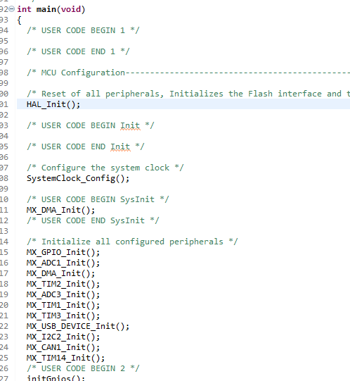

Now the second line SET_BIT(RCC->CR, RCC_CR_HSION) jumps to fault handler.
NASI
Senior
I made .ioc file for bootloader as the same as .ioc file for the application, and HAL_RCC_deinit() didn't jump to hard fault.
But the last line of the jump function Jump_To_Application() jumps now to hard fault interrupt.
