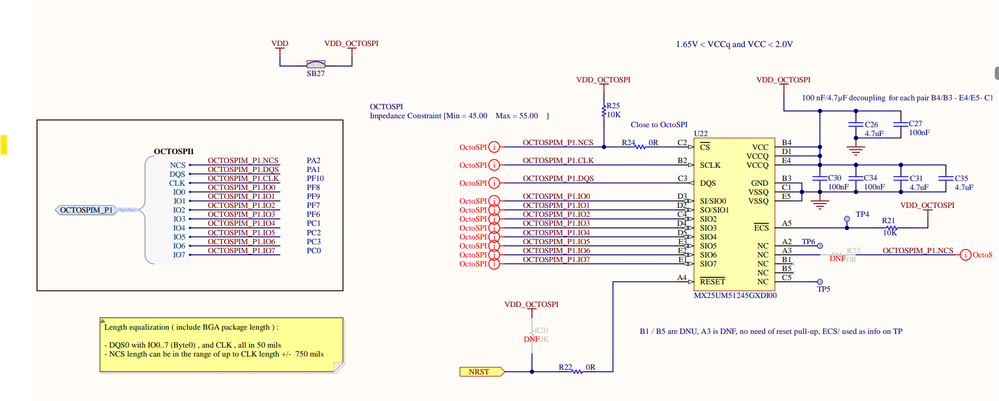

As per the schematic, the flash's chip select is connected to PORT1. When we configure the chip select option in OSPI2 as PORT1 NCS, we must disable it in OSPI1. In this scenario:

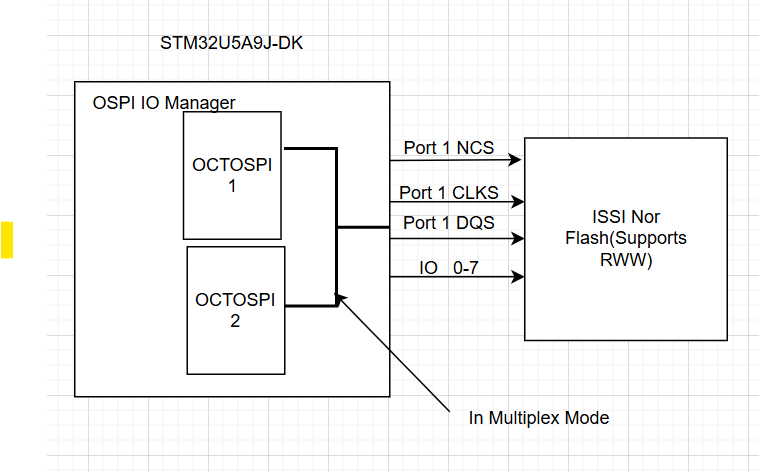

As mentioned, we understand that RWW needs to be supported by the Octal SPI NOR flash memory, which is true in our case. We are using ISSI Octal Flash Memory that supports RWW. We have connected the ISSI flash memory in place of the Macronix flash on the STM32U5A9J-DK as shown in the attached image.

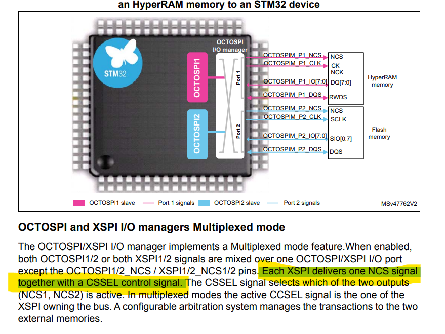

The RWW example provided by you is for the STM32H7S78-DK, which uses an xSPI IO Manager. However, our board (STM32U5A9J-DK) is equipped with an OSPI IO Manager.
Referring to the AN5050 (page 25):
- The xSPI IO Manager delivers one NCS signal along with a CSSEL control signal.
- It also allows selecting the same NCS for both XSPI_1 and XSPI_2 using the configuration.
XSPI Configurations for RWW example that you have given :
- hxspi1.Init.MemorySelect = HAL_XSPI_CSSEL_NCS1;
hxspi2.Init.MemorySelect = HAL_XSPI_CSSEL_NCS1;
sXspiManagerCfg.nCSOverride = HAL_XSPI_CSSEL_OVR_NCS1;
However, the OSPI IO Manager does not provide these options:
- When selecting Port1 NCS for OSPI1, it does not allow the same Port1 NCS for OSPI2.
- Instead, we either need to disable Port1 NCS for OSPI2 or switch to Port2 NCS.
As a result:
- If OSPI1 is configured to use Port1 NCS, OSPI2 stops working.
- Similarly, if OSPI2 is configured to use Port1 NCS, OSPI1 stops working.
This limitation seems to make it impossible to access the ISSI flash memory from both OSPI1 and OSPI2 instances simultaneously in multiplexed mode using the OSPI IO Manager.
