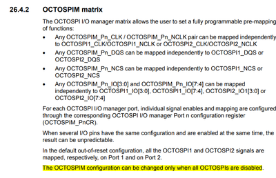

KDJEM.1
Hello @unsigned_char_array ,
Please make sure that both OSPI instance are disabled to configure OCTOSPI Manager. This behavior is mentioned in RM0468 Rev 3 section 26.4.2.
So I advise you to avoid the OSPIM configuration issue to call HAL_OSPIM_Config only one time at boot. After this, HAL_OSPI_Init() and HAL_OSPI_DeInit() can be called at any time.
Before called a HAL_OSPI_DeInit() it is necessary have to be sure that no Rd/Wr access are ongoing, especially in Memory Mapped Mode where there is no feedback on this access inside OSPI block.
I hope this help you.
Kaouthar
"Please make sure that both OSPI instance are disabled to configure OCTOSPI Manager."
HAL_OSPIM_Config does this automatically, but maybe it does it improperly. I will check if I can make some type of fix.
"So I advise you to avoid the OSPIM configuration issue to call HAL_OSPIM_Config only one time at boot."
As far as I know the flash loader doesn't really boot. It is loaded in RAM and then nothing happens. The debugger calls the Init function. The problem is that it does it repeatedly. I'll check if I can modify the Init function.
