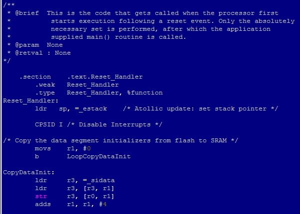

Is this the primary/only code in the system?
Or is there a loader or some other code that is run first, before this application?
Add "CPSID I" instruction as first thing it does in Reset_Handler
‎2022-06-09 11:22 AM
Hi
Yes, its the only code in the system, no loader is ran. I have never done assember on the STM32, only 68000 processors. Where would I add this line, and what exactly does this do?

‎2022-06-10 2:33 AM
‎2022-06-12 1:52 AM
Many thanks, that fixed one of the weirdest things I have saw in programming :)
