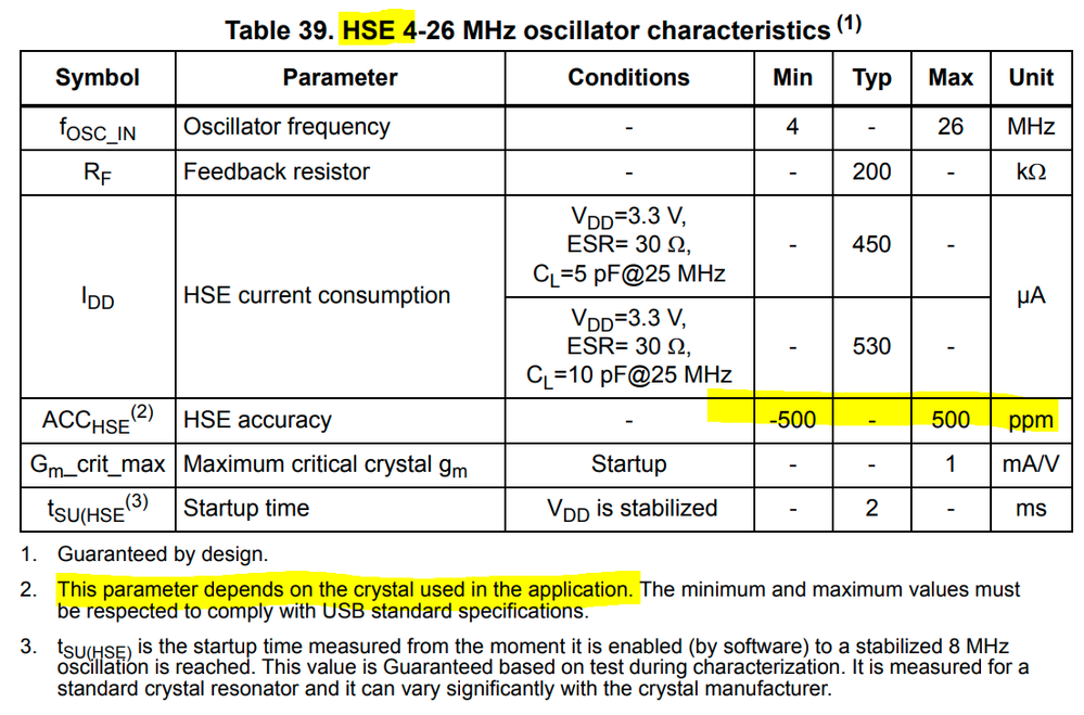

The datasheet says that the precision of the oscillations are of 500ppm (parts per million). So every 1000000 oscillations there can be a 500 oscillation shift compared to what a million oscillations should bring us, am I right ?

I'm guessing this is what you're looking at. Note that it's referring to the HSE accuracy with an external crystal, not the accuracy of the internal HSI oscillator, which is considerably worse than 500 ppm.
That's what 500 ppm means, yes.

What do you mean by "internal oscillator"?
Where does it say that? Post screenshot.

Thank you for your answers. This is the datasheet part I was looking at @TDK​ so I was mistaking HSE with HSI...
So this parameter doesn't mean anything for HSE,. If I chose to put a 20ppm accuracy crystal, it will stay unchanged right ?

Precision of oscillation frequency of a crystal is given mainly by the loading capacitance. Read AN2867.
Drift and jitter (i.e. how does it change in time/temperature, in long/short term) is a very complex topic; temperature has perhaps the most dramatic influence. The chip itself impacts drift/jitter only secondarily and only in minor way.

In crystal oscillator, the behaviour is mostly determined by the crystal and the loading capacitors (which includes parasitic capacitances of the tracks and pins, too). The STM32 does not influence it.
If you adhere to the recommendations, you will get the crystal's listed accuracy (barring a defective part).
I'm not sure why they list ±500ppm on the HSE chart. It seems misplaced IMO. Maybe they wanted to show that HSE is way more accurate and that you'd be hard pressed to find a crystal with less accuracy than 500ppm.
This is a common practice of semiconductor manufacturers, to place bogus parameters to the parameters table, just because users expect them to be there. Here, some dominant (read: $M++) user asked, "is HSE good for USB?" and this was ST's solution to assure them.
