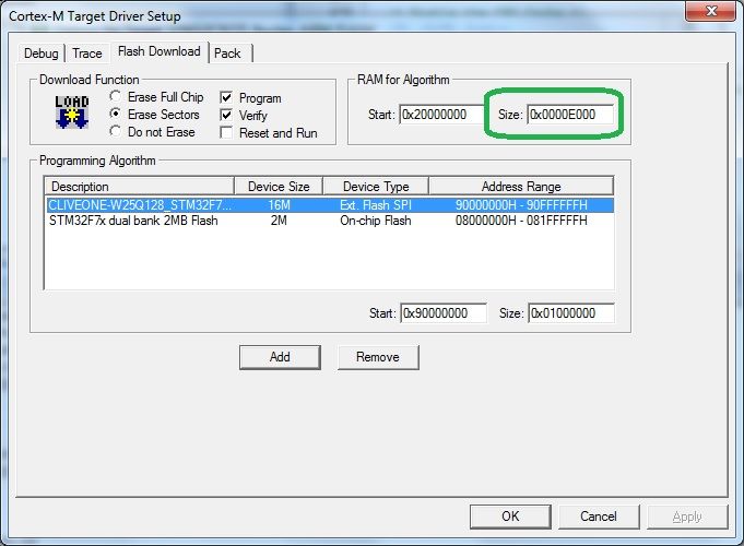

Might also want to tell the Flash Algorithm it has 0xE000 bytes of RAM to be usable
I am reading the AN333 from Keil.
It looks like I need to add/modify a few lines of code all over the place. And we will see later.

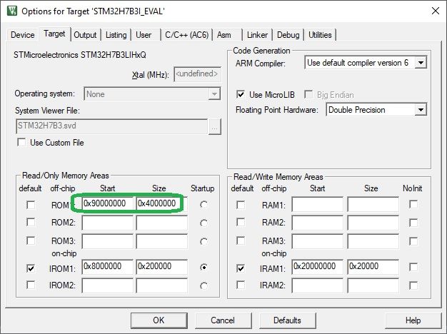

The QSPI/OSPI is in range 0x90000000 (7 zeros) not 0x09000000

After spending a few days I found that my sct file has to be modified
; *** Scatter-Loading Description File generated by uVision ***
LR_IROM1 0x08000000 0x00200000 { ; load region size_region
ER_IROM1 0x08000000 0x00200000 { ; load address = execution address
*.o (RESET, +First)
*(InRoot$$Sections)
.ANY (+RO)
RW_IRAM1 0x20000000 0x00020000 { ; RW data
.ANY (+RW +ZI)
RW_IRAM2 0x24000000 0x00080000 {
.ANY (+RW +ZI)
LR_ROM1 0x90000000 0x1000000 {
ER_ROM1 0x90000000 0x1000000 { ; load address = execution address
.ANY (+RO)
Before I had
0x09000000 0x0400000
so it shows now that it is erasing starting at 0x90000000 then programming
but at the end
I get
Erase Done.
Programming Done.
Contents mismatch at: 90000000H !
Verify Failed!
Error: Flash Download failed - "Cortex-M7"
Flash Load finished at 15:56:18
