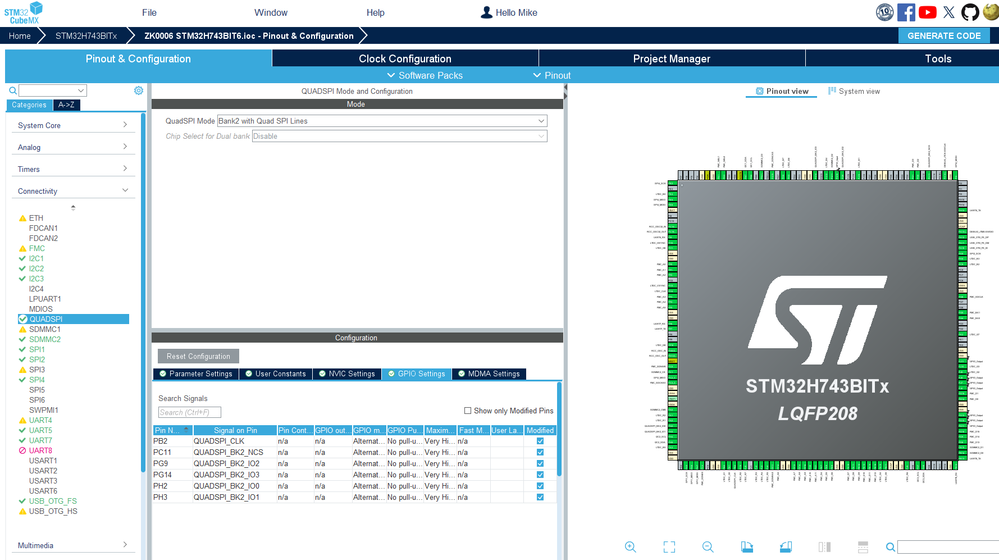

is it possibe to modify external loader (QSPI) to change pins ?
‎2024-04-14 2:04 PM
I fount this page, ready to go
https://github.com/cturvey/stm32extldr/tree/main/h7_mt25q128
I do have STM32H743BIT6 and MT25QL128
the pins are different, I wonder if it can be opened in something and change pins.

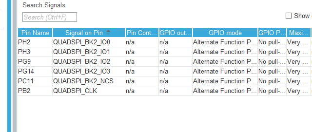

I do not know what you mean by mailing. I doubt that hex editor is going to show me the PINs unless I know how the PINs are coded. Or maybe you can see PB2-PB6-PD11-PD12-PE2-PD13 and just change. I did not try.
I tried to write my own loader something did not work. Probably something simple somewhere. There are bunch of youtube videos showing how to do it with with CubeMX IDE

Thanks I appreciate. When I designed the board I did not have in mind to use QSPI as loader this is why I did not pay attention to the PINs. But once I got this board working some new ideas came to mind.
I will try it later to see if I can load some more graphics.

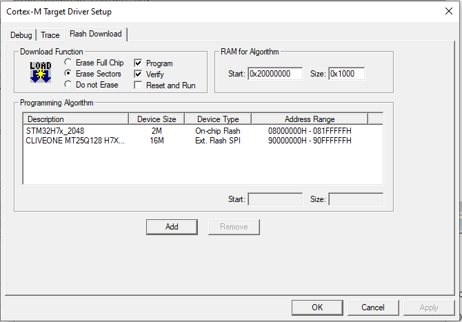

Keil .FLM for the aforementioned platform
https://github.com/cturvey/stm32extldr/blob/main/h7_mt25q128/MT25Q128_STM32H7XX-CUSTOM26.FLM
‎2024-04-18 1:15 PM - edited ‎2024-04-21 4:21 PM
The flash is working I checked by writing and reading data but not the external loader.

‎2024-04-18 3:07 PM
That's more of a Scatter File (Keil's Linker Script) issue about where different code/data sections are going to live.
Want your main code/data living in Internal Flash (0x08000000) and your "extdata" stuff living in External Flash (0x90000000)
Routing via name, object, or #pragma or __attribute__(section()) type directives.
