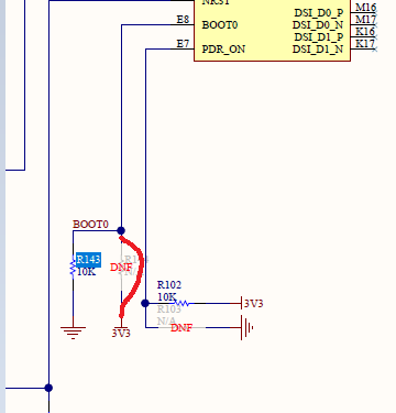

I mean in the schematic R144 is not there, if I apply solder to join those ends I would send boot0 to 3.3V and that would fulfill the step of connecting boot0 to VDD and be able to erase the memory and then remove the solder jumper right? with that I avoid soldering a wire to one end of R144 which is very difficult.

I made the following connection for boot0
if that's sending boot0 to vdd then I did everything as is, if you want I can try soldering a wire on one of the points and connect it to some arduino pin like 3.3v or 5v

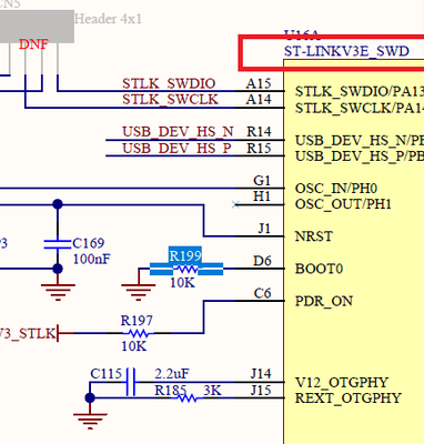

do i have a way to corroborate that this actually happens when i set boot0 to 3.3v?
You need to connect and disconnect this wire or "solder bridge" (0V or VDD) following the specific steps described above and you need to follow the exact steps with the same order. That's it.

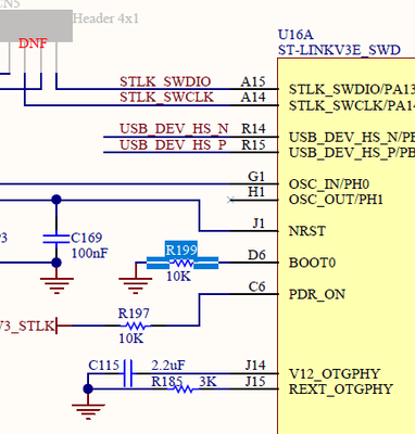

I found this also in the schematic, I will try to put a wire on R199 on the boot0 side and send it to 3.3v.
This is for ST-LINK module not for the MCU:
So again follow the steps as described in the article and use R144 to connect BOOT0 pin to VDD.
