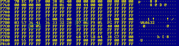

I've some troubles with the internal temperatur sensor from my stm32f051: If I read the adc_channel16 I get ~1920 as value. Then I calculate the result in this way �C = ((V25 - VSENSE) / Avg_Slope) + 25 = ((1.43V - 1.54V) / 4.3mV/�C) + 25 = -0.58�C But this should be ~22�C. Then I thought, that I could use the factory callibration data. But HOW? If I read the stored value like this ''(*((uint32_t*)0x1FFFF7B8))'' I get 100206271 as ''TS ADC raw data acquired at temperature of 30 �C, V

The 30 C and 110 C calibration values are 16-bit, not 32-bit

Calibration value name Description
Memory addressTS_CAL1 TS ADC raw data acquired at
temperature of 30 °C, VDDA= 3.3 V 0x1FFF F7B8 - 0x1FFF F7B9TS_CAL2 TS ADC raw data acquired at
temperature of 110 °C VDDA= 3.3 V 0x1FFF F7C2 - 0x1FFF F7C3 .ExternalClassB03E595537E44B59A949E22D56147C6B .telerik-reTable-2 {border-collapse:collapse;border:solid 0px;font-family:Tahoma;} .ExternalClassB03E595537E44B59A949E22D56147C6B .telerik-reTable-2 tr.telerik-reTableHeaderRow-2 {border-width:1.0pt 1.0pt 3.0pt 1.0pt;margin-top:0in;margin-right:0in;margin-bottom:10.0pt;margin-left:0in;line-height:115%;font-size:11.0pt;font-family:'Calibri' , 'sans-serif';width:119.7pt;border:solid white 1.0pt;border-bottom:solid white 3.0pt;background:#4F81BD;padding:0in 5.4pt 0in 5.4pt;color:#FFFFFF;} .ExternalClassB03E595537E44B59A949E22D56147C6B .telerik-reTable-2 td.telerik-reTableHeaderFirstCol-2 {border-width:1.0pt 1.0pt 3.0pt 1.0pt;border:solid white 1.0pt;border-bottom:solid white 3.0pt;padding:0in 5.4pt 0in 5.4pt;} .ExternalClassB03E595537E44B59A949E22D56147C6B .telerik-reTable-2 td.telerik-reTableHeaderLastCol-2 {border-width:1.0pt 1.0pt 3.0pt 1.0pt;border:solid white 1.0pt;border-bottom:solid white 3.0pt;padding:0in 5.4pt 0in 5.4pt;} .ExternalClassB03E595537E44B59A949E22D56147C6B .telerik-reTable-2 td.telerik-reTableHeaderOddCol-2 {border-width:1.0pt 1.0pt 3.0pt 1.0pt;border:solid white 1.0pt;border-bottom:solid white 3.0pt;padding:0in 5.4pt 0in 5.4pt;} .ExternalClassB03E595537E44B59A949E22D56147C6B .telerik-reTable-2 td.telerik-reTableHeaderEvenCol-2 {border-width:1.0pt 1.0pt 3.0pt 1.0pt;border:solid white 1.0pt;border-bottom:solid white 3.0pt;padding:0in 5.4pt 0in 5.4pt;} .ExternalClassB03E595537E44B59A949E22D56147C6B .telerik-reTable-2 tr.telerik-reTableOddRow-2 {color:#666666;background-color:#F2F3F4;font-size:10pt;vertical-align:top;} .ExternalClassB03E595537E44B59A949E22D56147C6B .telerik-reTable-2 tr.telerik-reTableEvenRow-2 {color:#666666;background-color:#E7EBF7;font-size:10pt;vertical-align:top;} .ExternalClassB03E595537E44B59A949E22D56147C6B .telerik-reTable-2 td.telerik-reTableFirstCol-2 {margin-top:0in;margin-right:0in;margin-bottom:10.0pt;margin-left:0in;line-height:115%;font-size:11.0pt;font-family:'Calibri' , 'sans-serif';width:119.7pt;border-top:none;border-left:solid white 1.0pt;border-bottom:none;border-right:solid white 3.0pt;background:#4F81BD;padding:0in 5.4pt 0in 5.4pt;color:#FFFFFF;} .ExternalClassB03E595537E44B59A949E22D56147C6B .telerik-reTable-2 td.telerik-reTableLastCol-2 {padding:0in 5.4pt 0in 5.4pt;} .ExternalClassB03E595537E44B59A949E22D56147C6B .telerik-reTable-2 td.telerik-reTableOddCol-2 {padding:0in 5.4pt 0in 5.4pt;} .ExternalClassB03E595537E44B59A949E22D56147C6B .telerik-reTable-2 td.telerik-reTableEvenCol-2 {padding:0in 5.4pt 0in 5.4pt;} .ExternalClassB03E595537E44B59A949E22D56147C6B .telerik-reTable-2 tr.telerik-reTableFooterRow-2 {color:#666666;background-color:#FFFFFF;font-size:10pt;vertical-align:top;padding:0in 5.4pt 0in 5.4pt;} .ExternalClassB03E595537E44B59A949E22D56147C6B .telerik-reTable-2 td.telerik-reTableFooterFirstCol-2 {margin-top:0in;margin-right:0in;margin-bottom:10.0pt;margin-left:0in;line-height:115%;font-size:11.0pt;font-family:'Calibri' , 'sans-serif';width:119.7pt;border-top:none;border-left:solid white 1.0pt;border-bottom:none;border-right:solid white 3.0pt;background:#4F81BD;padding:0in 5.4pt 0in 5.4pt;color:#FFFFFF;} .ExternalClassB03E595537E44B59A949E22D56147C6B .telerik-reTable-2 td.telerik-reTableFooterLastCol-2 {padding:0in 5.4pt 0in 5.4pt;} .ExternalClassB03E595537E44B59A949E22D56147C6B .telerik-reTable-2 td.telerik-reTableFooterOddCol-2 {padding:0in 5.4pt 0in 5.4pt;} .ExternalClassB03E595537E44B59A949E22D56147C6B .telerik-reTable-2 td.telerik-reTableFooterEvenCol-2 {padding:0in 5.4pt 0in 5.4pt;} Best regards- Mark as New
2013-05-16 9:13 AM
But why are they using 2 32Bit registers for each value?
You are confused, they do not, it describes two addresses for 8-bit bytes, which when combined represent a 16-bit value. The range no doubt fitting in 12-bit given the performance of the ADC. uint16_t ts_cal1, ts_cal2; ts_cal1 = *((uint16_t*)0x1FFFF7B8); ts_cal2 = *((uint16_t*)0x1FFFF7C2); from these you should be able to create a basis, and per degree scale from which to utilize the reading.Up vote any posts that you find helpful, it shows what's working..
