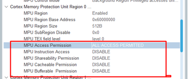

jerry_sandc
After using MPU to setup region with all features disabled, it acts normally now.  We can read single 16-bit address now.  But please note there is no 'Device' attribute, we just disable all cache permissions, instruction access, etc.

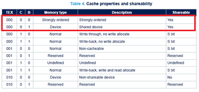

There is no implicit/direct confing for Device attribute:
MPU attributes are defined by their settings (as you did).
What you set is the Strongly-Ordered attribute would also solve the problem as Device attribute.
See this table from the AN4838.
Pavel A.
@mƎALLEm So in context of this question, what is better: "shared device" (TEX=0) or "non-shareable device" (TEX=2) ?
