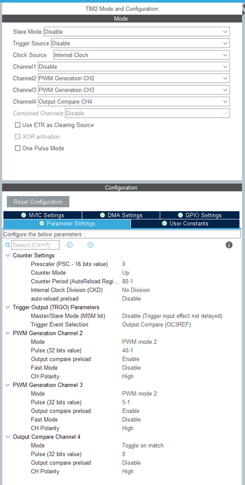

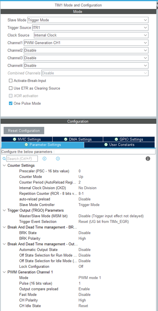

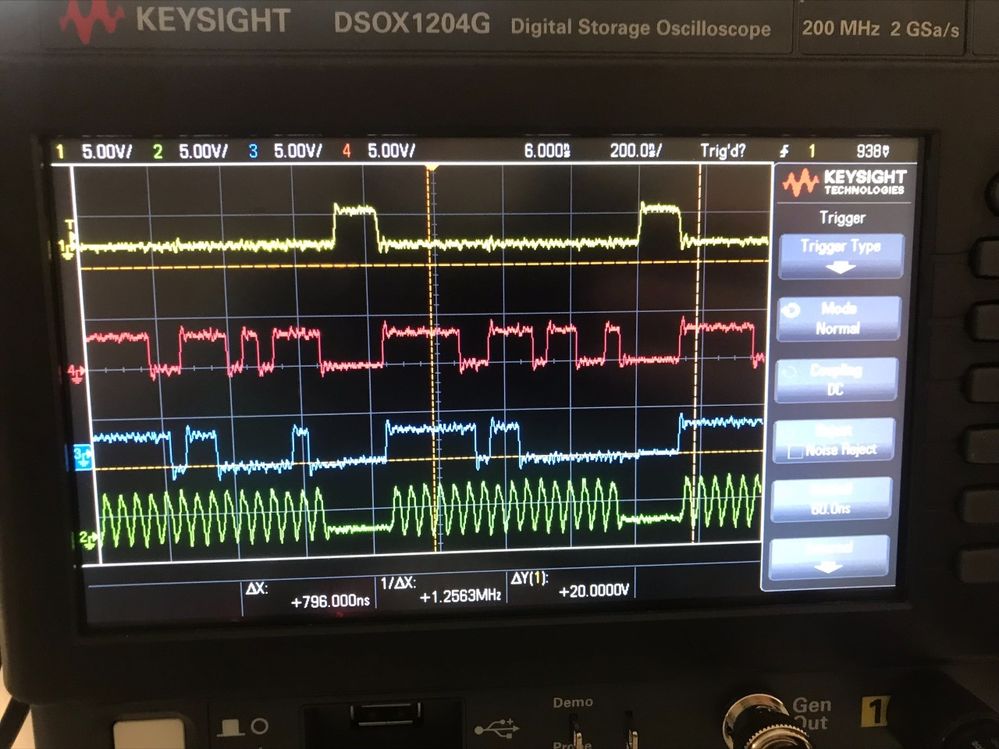

Here are my settings and waveforms:

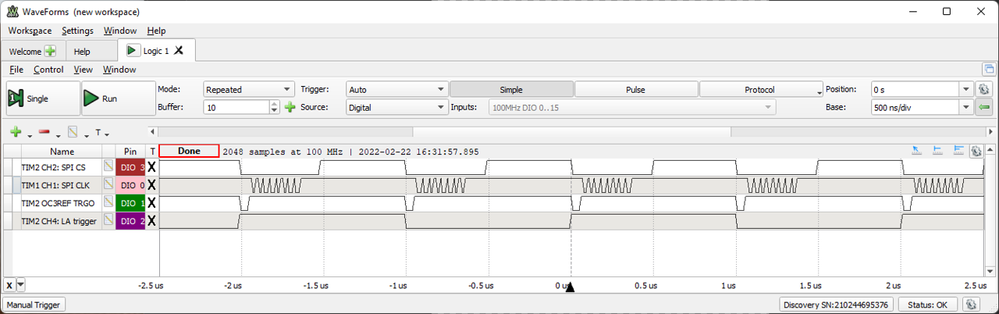

‎2022-02-22 8:44 AM
I've replicated this on my side now! The red and blue waveforms are the dual ADC outputs.
May I ask if it is possible to increase the OC3REF TRGO pulse width by 1 more clock cycle to delay the sclk a little more, to relieve the timing a bit. I don't think it is a big problem if this is difficult to do (I already tried changing the pulse of TIM2, channel3 but it didn't help).
I'm going to try and implement the 2 slave SPI with DMA now! I'll let you know how I get on.
Thanks again.
‎2022-02-22 9:20 AM
Nice. If you set TIM2 CH3 Pulse to a larger value, say 9, the SPI clocks move right. I do that in the debugger with execution paused and setting the registers in the SFR View (STM32CubeIDE) until the waveforms fit. The 80 MHz clock is also arbitrary as it was max. on the L4.
hth
KnarfB
‎2022-02-22 12:07 PM
Thanks, I will give that a try tomorrow when I have access to the oscilloscope, although I thought I had already tried that...

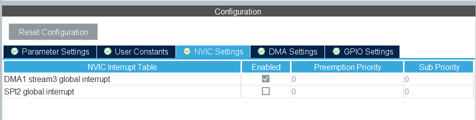

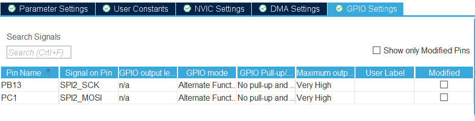

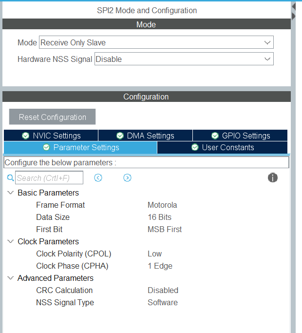

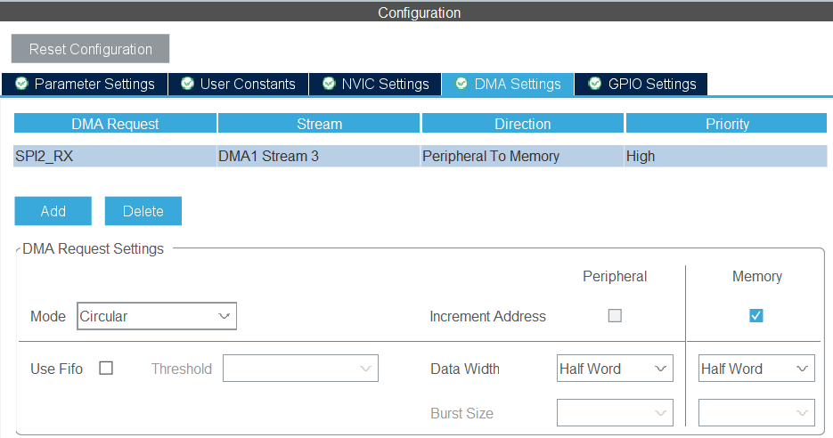

My SPI DMA receive callback does not seem to run. I am configuring a single SPI currently as shown below:
With the following code:
//before main:
uint16_t buffer[100];
__HAL_SPI_ENABLE(&hspi2);
HAL_SPI_Receive_DMA(&hspi2, (uint8_t *)&buffer, 1);
//after main:
void HAL_SPI_RxCpltCallback(SPI_HandleTypeDef * hspi)
int a; //BREAKPOINT HERE
When running the code in debug mode with a breakpoint on line 9, I would expect the callback to run because data will be read by the slave SPI.
In hardware I have connected:
SPI2_SCLK -> Timer 1 pulse output
SPI2_INPUT -> ADC_output_A
Do I need to trigger the read of the SPI? Or should this happen automatically if it is fed the clock? Do I need to enable hardware NSS, and also connect the CS, I tried this but got the same result?
Thanks!
‎2022-02-23 5:30 AM
@KnarfB​
I moved up the line "MX_DMA_Init();" so it was above "MX_SPI2_Init();", and I am now receiving the callback interrupt. I believe this is a bug with the code generated by cubemx when it is integrated with the IDE. I will let you know if I can get valid data out :)
EDIT: DMA correctly writes data to the buffer. Second SPI slave can be enabled in the same way as the first to achieve dual data transfer.

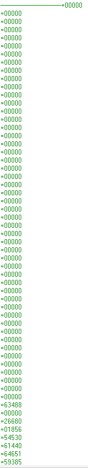

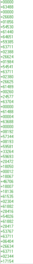

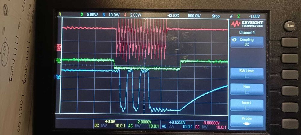

Hello ,
I am using stm32h7 and needs to read data from ads8661, I followed the above and managed to get the following graph. what I noticed is I also get the data value in the MISO line as shown.
RED is the clock connected to TIM1_CH1
GREEN is the CS pin connected to TIM2_CH1
BLUE is the MISO pin
when I configure the SPI as and how it is done above i.e Recieve only slave mode with DMA I am reading garbage values.
I used the following code
HAL_SPI_Receive_DMA(&hspi2, (uint8_t *)&buffer, 2);
HAL_TIM_PWM_Start(&htim1, TIM_CHANNEL_1);
HAL_TIM_PWM_Start(&htim2, TIM_CHANNEL_1);
while(1)
HAL_Delay(1000);
HAL_TIM_PWM_Stop(&htim1, TIM_CHANNEL_1);
HAL_TIM_PWM_Stop(&htim2, TIM_CHANNEL_1);
HAL_UART_Transmit(&huart3,"-------------------------------\n", 30, 10);
for(int i=0;i<100;i++)
sprintf(UART3_rxBuffer2,"=%05d\n",spibuffer[i]);
HAL_UART_Transmit(&huart3, UART3_rxBuffer2, 7, 10);
memset(buffer,0,99);
HAL_Delay(10);
SPI2_SCLK -> Timer 1 ch 1
SPI2_INPUT -> MISO
screen shot of Garbage values printed on console
starts with 0's and followed by
why the value read are garbage values ? shouldnt it be a constant according to the MISO line in the scope?
Thanks!
