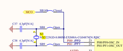

It seems there may have been some misunderstanding in my previous message. The component is a crystal, not an oscillator. I understand that the default setting for the Nucleo-F767ZI board is to use the clock output from the X1 on the ST-LINK. I am not sure if this clock is from an oscillator or a crystal, but when using this default setting,
I set RCC_OscInitStruct.HSEState = RCC_HSE_BYPASS;.
When I attach a crystal to X3, I set RCC_OscInitStruct.HSEState = RCC_HSE_ON;
What I’m curious about is whether it’s normal for the system to work properly regardless of which of the above two settings is used, whether the board has a crystal attached to X3 or is used in the default configuration without the crystal.

If you use the wrong one, the HSE won't work - but the chip can "fall-back" to using an internal oscillator.
By default, the chip can use an 8 MHz signal (HSE bypass) that comes from the ST-Link.
If you solder X3, you need to also open SB149 and close SB8 and SB9 in order to use the HSE. Otherwise, your crystal is not actually connected to anything and trying to use it will result in the chip using the HSE Bypass signal instead.

If using X3, I am following the guide provided in the UM1974 document.
HSE on-board oscillator from X3 crystal (not provided): for typical frequencies and
its capacitors and resistors, refer to the STM32 microcontroller datasheet and to the
Oscillator design guide for STM8S, STM8A and STM32 microcontrollers Application
note (AN2867) for the oscillator design guide. The X3 crystal has the following
characteristics: 8 MHz, 8 pF, 20 ppm. It is recommended to use NX3225GD-8.000MEXS00A-
CG04874 manufactured by NIHON DEMPA KOGYO CO., LTD. The
configuration must be:
– SB148 and SB163 OFF
– SB8 and SB9 ON
– C37 and C38 soldered with 4.3 pF capacitors
– SB112 and SB149 OFF
In this case, even if I set HSEState to RCC_HSE_BYPASS, the Nucleo-F767ZI operates normally.
