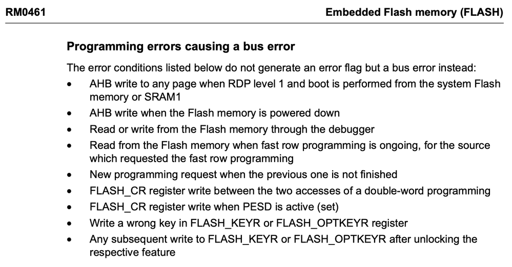

From the documentation:
Interestingly the doc says nothing of the CR LOCK/OPTLOCK bits being inaccessible when CFGBSY.
The application at that point is not aware of the issue. Further a FLASH write is done and the CPU enters a Bus Error when trying to access the CR register to Lock the FLASH Memory.
From de Documentation:
The documentation says nothing about Bus Error in case the CFGBSY bit is set when accessing the CR register LOCK/OPTLOCK bits.

The program in the opening post is invalid as it tries to write to flash with no special precautions or setup.
CFGBSY is readonly. It can't be set or cleared in software. Presumably it would be cleared when the rest of the flash word is attempted to be written (which will fail if flash is locked).
