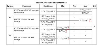

The minimum voltage of the wave is 0.6V. I am suspecting that might be too high to be considered a logical 0 but I can't find documentation.

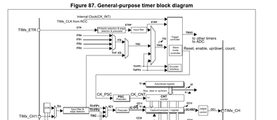

To count frequency, need to use external clk input for timer .
This from F407 ds , you didnt tell your device.

In its datasheet it says "1.7V<=V_DD<=3.6V". I am correct to then say that my 0.6V should get read as a logical low, right?

You didnt understand, what i tried to say :
you should not use "capture mode" or so, but external clk input + gating the timer for (typical 0,1 ...1 sec);
then you see in counter the counted pulses, in 1 sec gating -> 1,2 mio pulses (only with TIM2 , 32bit possible),
otherwise 16bit counter would overflow.
TIMx_ETR is the input for counting external frequency . So you get max. resolution .

@Qwyntex To address your point and @waclawek.jan 's question about if the logic level of the square wave is sufficient, you can look directly at the bit in the GPIOx->IDR register for that pin. It should be flipping between 0 and 1 with some regularity. (With debugger running, hit pause, resume a few times to get new values). Probably that is not the issue. 640 mV should work as logic low.
