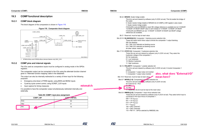

Information mismatch for COMP1_INP in RM0394

@mƎALLEm ,
Thanks for this information. So, it appears, that - apart from the confusing footnote in Fig.118 - the probem was probably somewhere in  @y_liosha 's code, correct?

Hello @waclawek.jan ,
I do agree. There is a mismatch in the documentation. I'll escalate the case internally for analysis and eventual fix. Internal ticket for follow-up: CDM0059567
Thank you for your contribution and sorry for the late answer.
