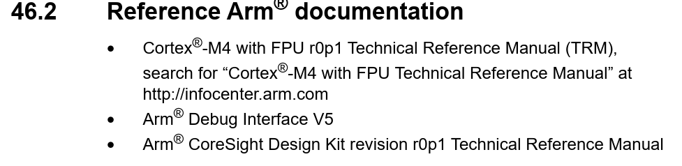

I am missing a detailed description of the DBG (DWT) registers in RM0440 chapter 47.Also in the PM0214 I could not find any details. In what document are these registers described?
Thanks

the debug is part of the Arm Cortex-M4 core, so look at arm :
>> Debug registers are described in the Armv7-M Architectural Reference Manual.
in RM :
‎2022-12-22 12:06 AM
in RM :

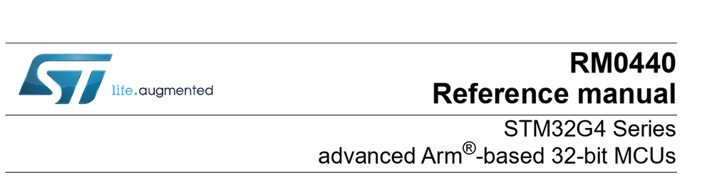

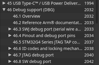

‎2022-12-22 12:51 AM
Thank you.
What exact document is the screenshot from? The Armv7-M Architectural Reference Manual looks different. In my RM0440 chapter 46 is USB related.
‎2022-12-22 1:36 AM
screenshot from:
STM32G4-serie-manual
RM0440 rev.2 .
‎2022-12-22 2:26 AM
Ah ok. I got rev3.
